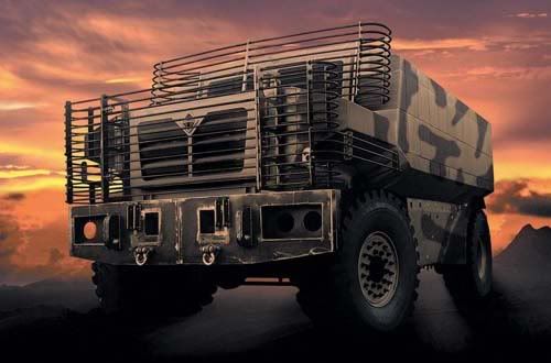

safety is relative
The forward control vehicles will always be less safe in a frontal crash than a truck that has the mass of the engine, frame and bumper out in front. The cab of the Fuso FE and FG models was redesigned recently (2005?) to add more crush space, give more headroom, and to add a safer steering column.
But it's all relative. If you're looking for the safest vehicle to have an accident in, you'd buy a cement truck. Or maybe an International MRAP.
