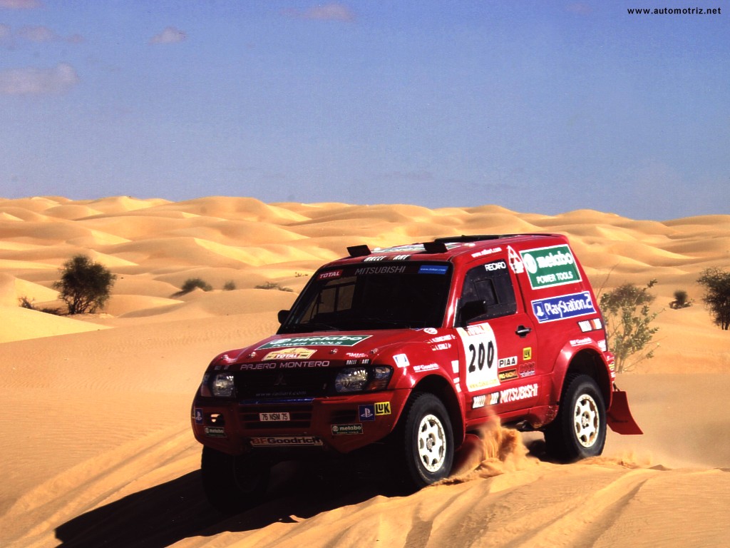

Also noticed the RallyArt teams had side exhaust -
(Look Closely)

For the Exhaust, I prefer the dual exit style, but rally raid vehicles also ran a single center exit pipe.
