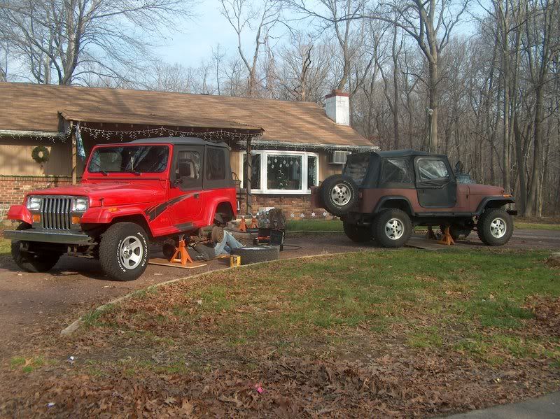

OK, after a week on the "honey do list" were back on the swap. Gary is off today and we started the suspension and axle swap. Thank God for decent weather...wish i had a garage.

ok guys, heres whats done so far...
Rear springs are installed along with the ford 8.8. Its sitting real nice in the rear with the 32" BFG MT'S
Noticed the clutch grabs real low, might as well replace while the transfer case is out. Looking into a Center Force II.

Making progress, lift and axle swap are completed. Rain has been an issue the last two days, would have liked to get a bit more done.
I received the shift fork pads for the transfer case only to find the shift fork itself worn when i attempted to reassemble. How i missed this i'll never know. Fortunately i had another transfer case for parts under the workbench and grabbed the fork from it. We should have it ready for assembly this weekend.
