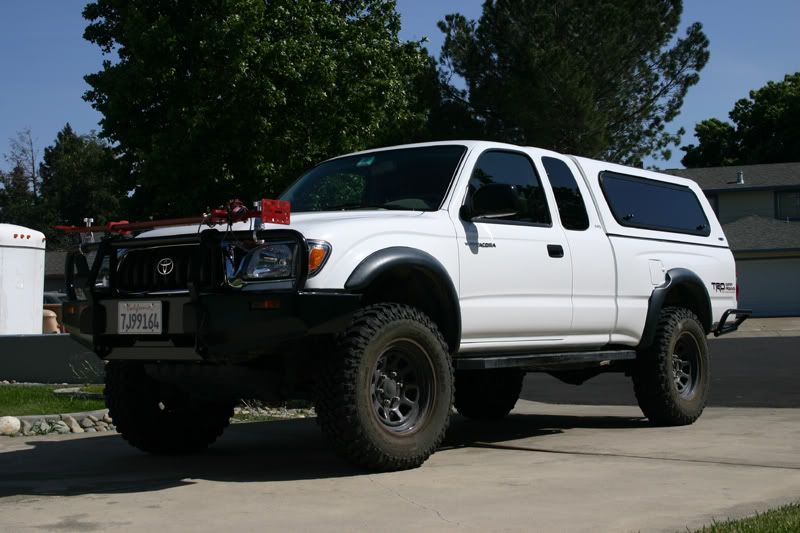

Update!
I'd been looking at getting the bed of my truck spray-lined for a while... I couldn't stand the texture and thick, chunky lay of Rhino Linings, but also couldn't bring myself to pay the $550+ for Line-X over the rails... A buddy of mine recommended me to a local chain, Campways, and their spray-in liner which he had applied to his Tacoma... After reading a bit online and going down to the showroom to check out some samples, I made an appointment. The spray is officially Specialty Products Incorporated's "Full Metal Jacket" - looks and feels very similar to Line-X, but without the heavy price tag; perfect!
Before:
(clickable)
(clickable)
After:
(clickable)
(clickable)
Once I got the truck back, I didn't waste any more time being lazy and got two more additions squared away.
The first are two pieces from Pro.Fit International, their 'Vehicle Specific Mount' and 'Express Mount'. I've seen a few, less expensive variations of these mounts, but Crutchfield carried this particular brand and that sealed the deal for me. The little bugger is very handy for keeping my Yaesu VX-7R in a upright, easily visible location that is within arm's reach. The Express Mount has a slot that accepts the button stud on the back of the radio, and the little rubber pad on the mount also keeps the radio from rotating or swinging around on it's button as we bounce down the trails. The mount install was straightforward, and the bracket does not interfere with the glove box or the air bag.
(clickable)
(clickable)
The second addition is a set of trick little Modular Hi-Lift Mounts from Fourtreks Off-Road... The jury is still out on these, though. They are very high quality products and very stout, but I had the wing nuts come loose (more than once) during a recent trip. Seems as though the constant vibration worked them loose, even after I cranked them down as tight as I reasonably could... I've installed a lock washer between each wing nut and the Hi-Lift and will see if that keeps them from loosening up again... They may be a little too *bling* for some folks, but I feel that the quality and attention to detail on these babies is worth the price if appearance isn't an issue. I did mention to Luke at Fourtreks that he should consider making a small batch and having them anodized black, just to see how they sell versus the standard finish...... If the lock washers work out, and I can get them to stop vibrating loose, my set will definitely be visiting a local powdercoater for an aesthetic overhaul.
(clickable)
(clickable)
(clickable)
(clickable)
Terracoma
Overall photos after the spray-liner and Fourtreks mounts:
(clickable)
(clickable)
Two weeks or so went by and I couldn't take it anymore; I had to have something over the bed rails... After oogling the BajaTaco, several other sleeping platform designs, and talking with a like-minded friend, I decided that a fiberglass truck cap would suit me best. But which one? There's only several handfuls of manufacturers out there... Another trip down to Campways got me straightened out. I narrowed it down to the Leer 100R or the SnugTop Cab-Hi, and after a day or two or thinking it over, I decided on the SnugTop. My friend also told me his 'woulda-shoulda' regrets after having put 10,000+ miles on his cap, so I promptly specified a front tilt-down sliding window, dual side windoors, and Yakima tracks installed in the roof for mine.
(clickable)
(clickable)
(clickable)
So far I'm very happy with the cap, especially for the price. The additional weight over the rear axle made a noticeable difference on the pavement, the rebound of the rear shocks is no longer bone-jarring going over large speedbumps, curbs, and small Hyundai sedans at anything faster than walking speed. Body roll has increased a little too, not much, but just enough for me to take notice while cornering at speed...... The real question, how well does it camp? I intend to find out, but I need a solid weekend to give it a good breakin' in!
