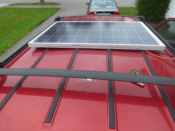

I've just ordered a 100w solar panel + charge controller that I am planning to mount between the roof rails on my 1998 Jeep XJ. The panel should be enough to run an Indel B 51qt fridge indefinately. It will be charging the main group 34 Odyssey battery and if that gets full, it will top up the second battery.
The panel is 40" tall and I measure the roof rails to be 45.5" apart so I will need to do a little fabricating, but the goal is to make it sit as low as possible between the rails. I haven't been able to find examples of this size panel on an XJ so I will try to take a useful amount of pictures.

The first box of parts arrived today. The panel will fit like the measurements said. I think I will go to the junk yard and get some extra roof-rack parts to make a somewhat removable attachment.

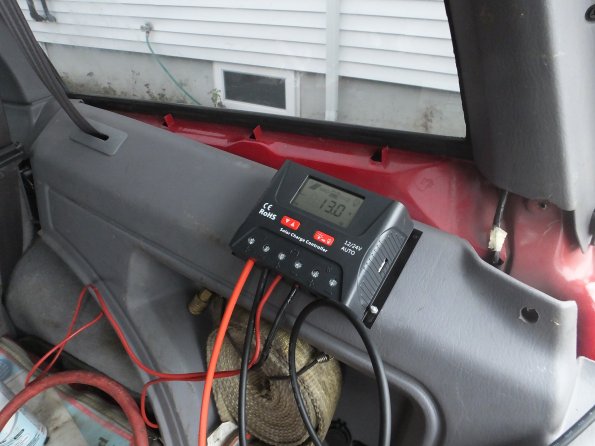

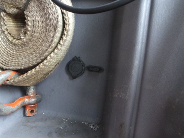

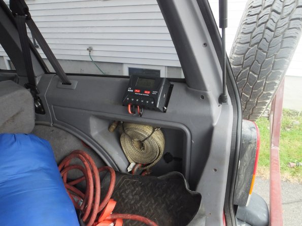

I wasn't able to just exchange the broken charge controller which was too bad because I had gotten an open box deal. The replacement panel and controller arrived and I got an extra set of roof cross-bars at the you-pull junk-yard. Saturday I mounted the charge controller and wired it to the battery.. This was easier for me as I already have a big 12v circuit for the air compressor in that area. While the panel was removed I added an outlet for the refrigerator.
This was as far as I got before leaving for an overnight trip.

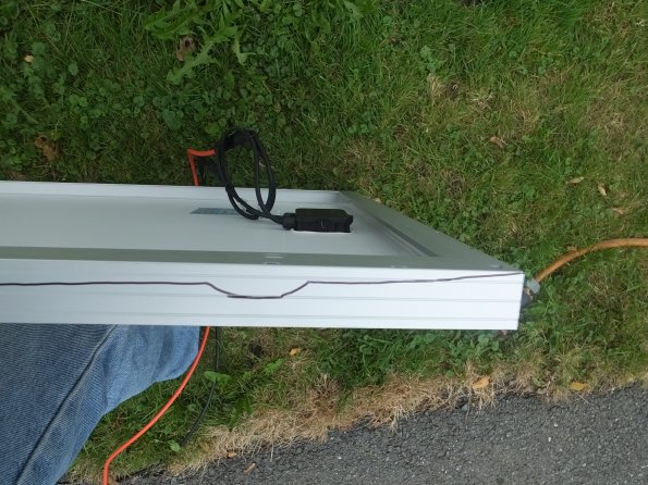

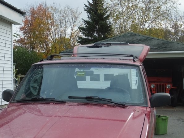

Today I worked on this a little more. I decided to hack up my brand new solar panel to make it sit a little lower on the roof. I scribed a line that would have it sit flush all the way across.
Unfortunately the junction box on the back of the panel won't let it sit this low so I cut a little less.
I won't end up using any of the roof-rack parts from the junk-yard for mounting. I need to buy some aluminum to finish mounting to the roof so I moved on to wire routing.

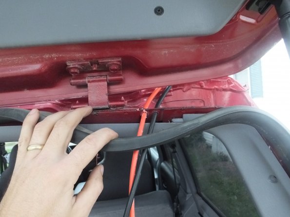

I found a place in the lip around the lift-gate where there were only two thicknesses of steel so I drilled some holes for the wires from the panel, then dismantled more of the interior to route them to the charge controller

Finished mount
