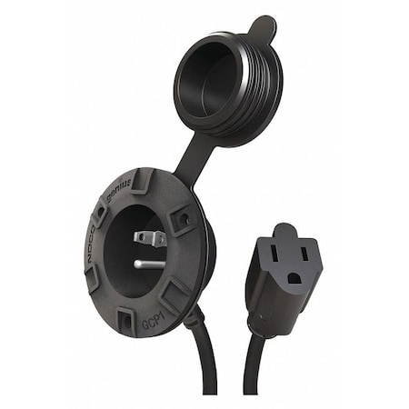

this is what i was thinking to install in my wheel well back where my goal zero is located so i can just plug into that from the camp hook up then just have my goal zero AC charging cord already plugged into the other end of that set up. under my wheel well boxs.

I got one of those but the attached pigtail was way to short for where I wanted to install in my rear bumper. You will most likely need the 30 amp RV adapter.
didnt see both links i have the 30 amp pig tail yellow and black adapter just ordered a port ac plug in with 2 18" pig tails on the inside van side to mount under where my goal zero is.

Thanks guys that’s the info I needed. I bought this. I’ll plug my electric heater into one pigtail and the other into my goal zero just to charge if needed. also bought a 30amp surge Protector pigtail.
