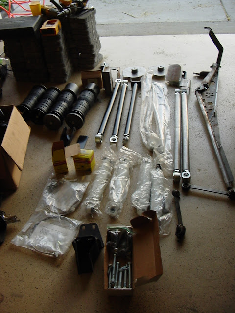

We started out with a BUNCH of parts

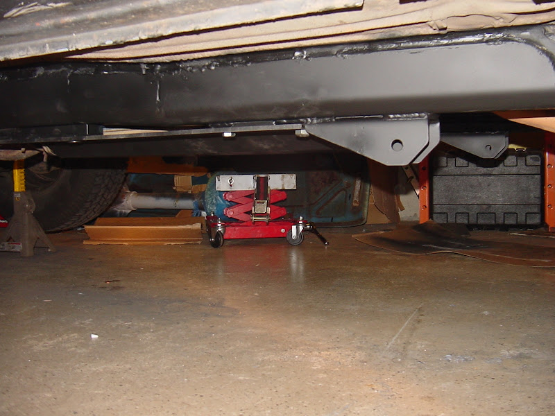

Added some TNT chassis stiffnerz

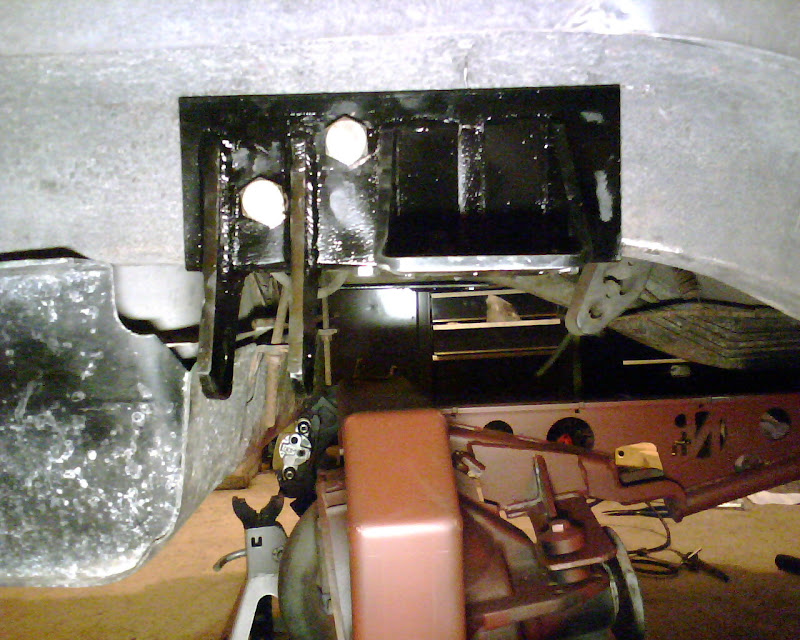

Before putting them in place we welded up the RockKrawler LA front mounts and a set of Poly Performance link mounts for the back. Welding those 'in position' is sooo much easier. Installing the stiffnerz on an old XJ covered in tranny fluid is another bit of fun.

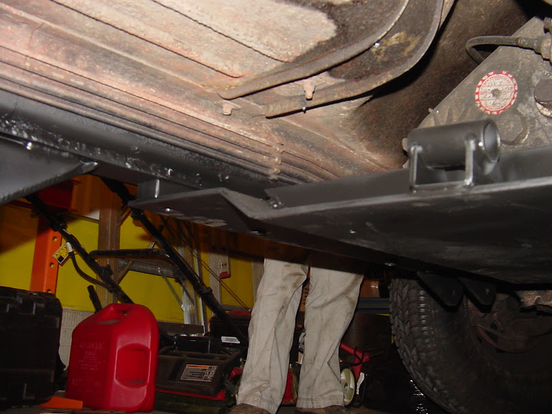

We also decided it needed a TJ like belly pan. So 1/4" of steel plate was bent and welded into place, on the back you can also see the Nth Stinger mount..

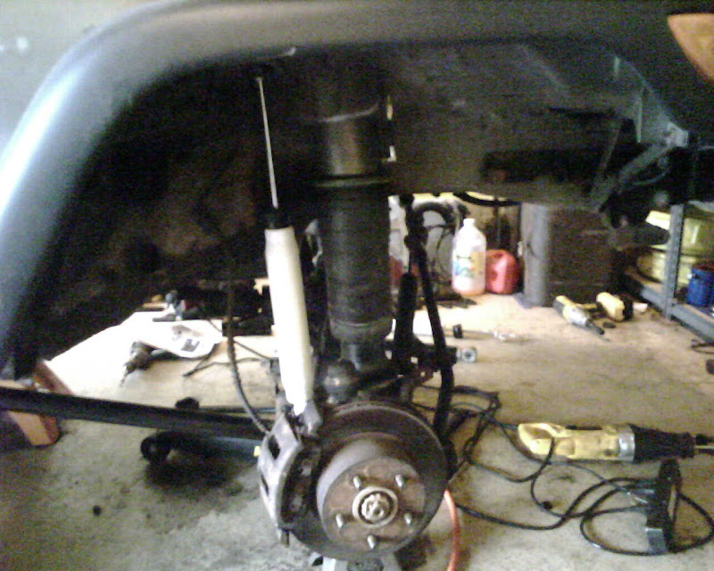

Next up, crappy cell phone pic of the front air backs and RK front 3 link setup in place

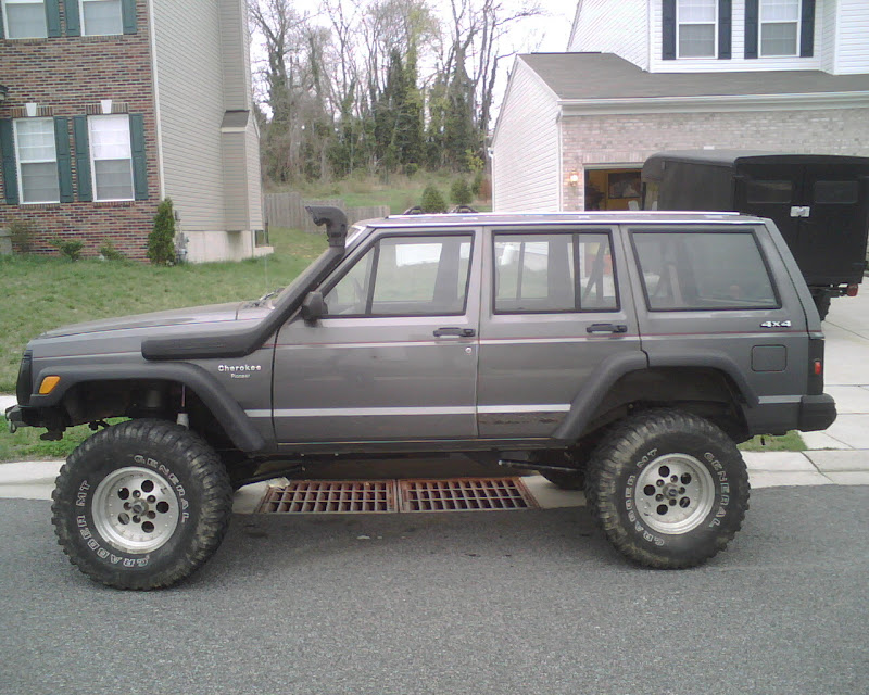

Then the mostly finished product:
The owner is in the process of finishing up a few touches.. I think just the rear DS is left to do.
