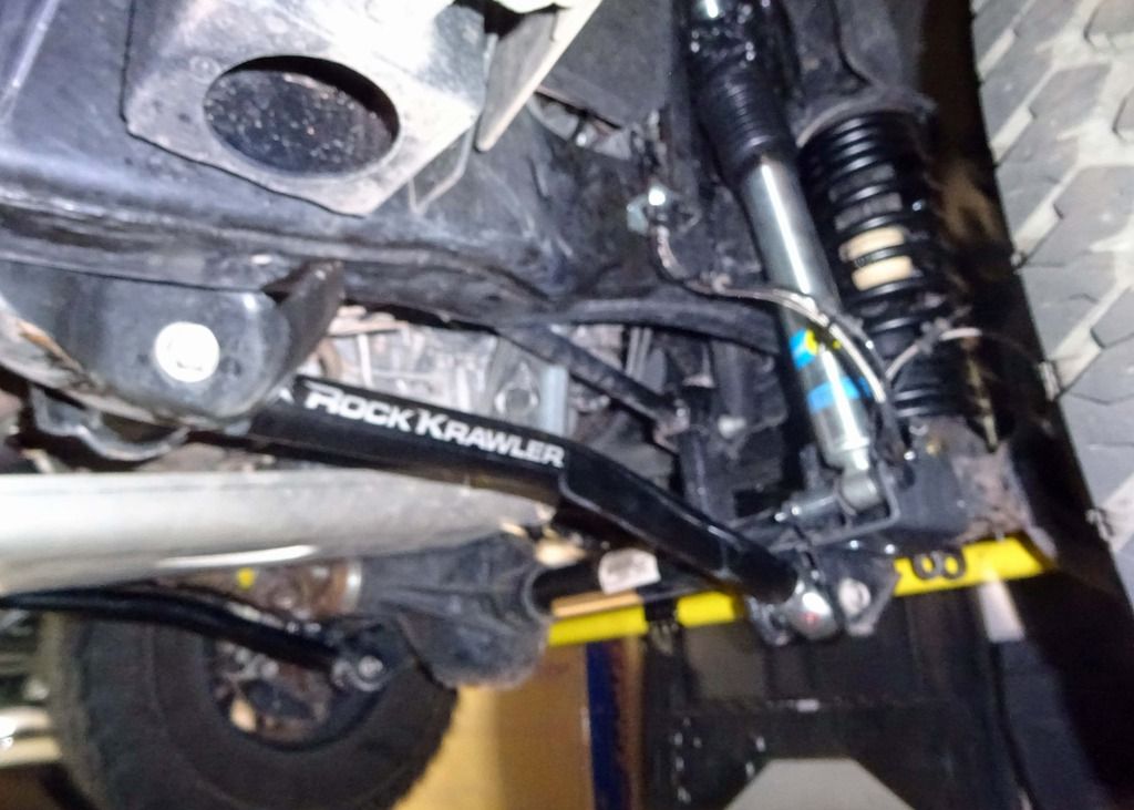

Decided to go with a Rock Kralwer 2.5 with Mid arms. Flex System (See video below) Part of the reason was a progressive spring with Rock Kralwer vs. the other brands. Part was geometry correction with mid arms vs brackets with stock arms. Part of the reason was lots of folks rave on this and the Jeep / Fab guy Don @ RPF Fab in Tempe suggested it. I was originally leaning towards the Mopar kit with Fox and brackets.

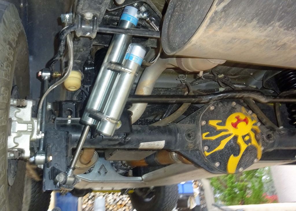

The folks at Rock Kralwer were kind enough to potentially resolve one issue with the rear weight. Swapped out a 3.5” rear on the 2.5” kit. Had to postpone the lift a few weeks waiting on the replacement springs, but no big deal. Without the trailer, there is a slight rake to the Jeep. Not bad, ½” at the rear. Again, the 3.5” is progressive so we will see next time we take the trailer out. With luck we will do just that in late April.
On the shocks we used the Bilstien 5100 which seems to be a pretty popular option. Decided to go remote reservoir on the rear as had some rear shock fade with stock units. Should help with the fade.

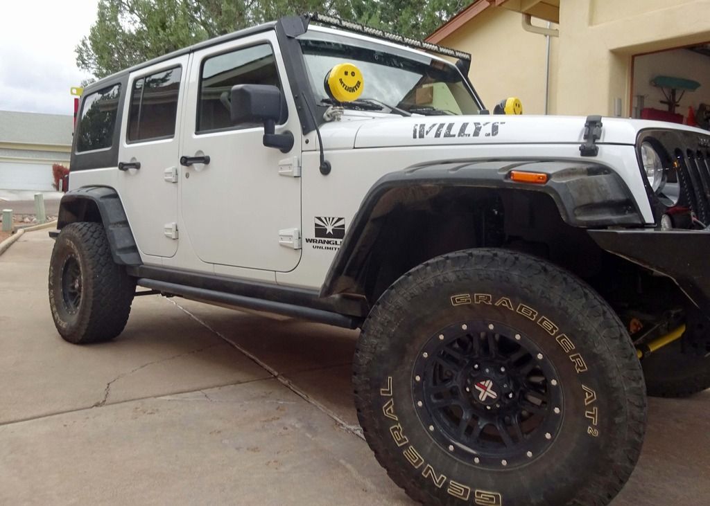

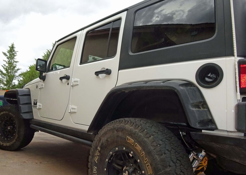

How it sits now:

Snazzy remote shocks.
Mid Arms and non remote fronts:
And, again, how it sits:
