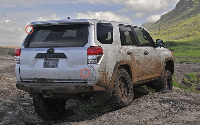

On the picture below I have circled where I would like to mount these antennas. The higher one on the drivers side would be the VHF/UHF antenna. The lower would be the CB.

Those both look like good solutions, but personally I don't have any experience with lip mounts.
You will get a little more range in front of your truck than behind with the antennas in the back. If your Firefly doesn't stick up above the roof line, it's going to limit your CB range. If it's only a 3-footer you would be better putting it up front on the hood or the front bumper. But if you're like me and only use the cb to talk to other ham-less trucks in a small trail group, then it won't matter as much.
Yea the CB will just be for trail comms with other vehicles so I am not too concerned about range.
Why not mount them both in the upper position on opposite sides of the hatch? There'd be enough distance from each other so that coupling problems wouldn't be an issue.
That's what I was thinking about. I am probably going to end up getting another Wilson 1000 roof mount because there is already a hole in the roof for the XM antenna. The Wilson 1000 can fit with a little trimming.

Would a NMO through-roof mount with its superior ground plane make more sense for your amateur radio, while using a lip mount for the CB?
The difference in counterpoise whether it were centered over the truck or lip mounted wouldn't amount to a perceptible difference on FM.
Why is this, and what is your definition of "perceptible"?
I have read elsewhere on the interwebs that people swear by the NMO roof mount for max range at 2m and/or 70cm λ. I had pretty well decided to make the commitment and drill that hole in the center of my roof until you said this; now I'm second guessing between this and a front fender lip-mount. If you have further reading you would suggest on the subject, I would appreciate it, as I don't want to drill that hole only to regret it.
NMO in the middle of the roof is best. There's a reason why it's still the way 99.999% of all commercial antennas are mounted. Less pattern distortion, lower noise floor, mechanically secure, no pinched coax. Whether or not it's worth it, that's a question only you can answer. I punch holes personally.
I have had 3 of those Diamond lip mounts, and I would NOT put a Firestick on them.
If I recall correctly, firesticks are those CB antennas that are approx 3/8" to 1/2" thick?
The only thing that holds those lip mounts to the body are two small allen set screws.
Putting a heavy, sturdy antenna on a lip mount, and then driving through brush like we do, you're going to break the mount or bend the body where the lip is attached.
I have two NMO mounts up on top of my 4runner, one for ham, one for CB. Both antennas are Larsen; NMO2/70, and an NMO27B. Both are whip type antennas, so no breaking on the trails :D
I have a Wilson 1000 through-the-roof with a 60" whip and have no regrets- the reception is fantastic- 1.5 miles in the suburbs is no problem at all, and my CB radio is pretty cheap and ordinary.
I'm getting ready to do a 2m/70cm antenna, and will do an NMO through the roof also.
In my opinion, drilling a hole is no big deal. Just do it right so that it doesn't leak or rust.
