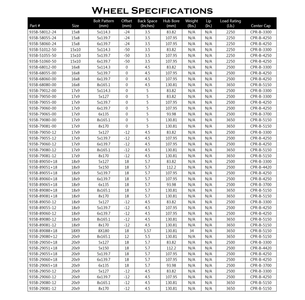

New Chev 3500 SRW. If I had to guess, the factory 18" alloys probably have a load rating around 4k. Problem is, that's only a guess and for whatever reasn, GM ain't talking. After a lot of searching, the only aftermarket 18" 8X180 alloy wheel I could find (with specs) with greater than 4k load rating was Method NV HD series wheels (4500#). I don't hate Method, but I thought I'd ask if anyone has come up with something better? Staying 18" and don't really want steel. Thanks!

Raceline Defenders Im running (18x9) are rated at 3650#
As I recall, it was the highest load rating available in that size Raceline had available at the time.
And looking at the sheets of Raceline truck wheels, I think they might simply max out @ 3650#
At least for "off the shelf" options. Raceline does have custom built options that might spec higher
https://racelinewheels.com/truck/suv
https://racelinewheels.com/939p

Thank you sir. At present, the Method NV HD wheels are the winners. Hopefully I'll get a response from GM regarding the factory alloy rating. Ha! Best tire for me comes in at 4080, so the Methods will have me covered. I'd prefer to keep the stockers (wheels), but want hard numbers that don't seem to be forthcoming from GM.
