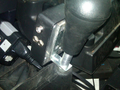

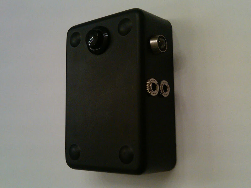

I run a Yaesu FT7900 and need a PTT and headset.... so I made my own!
This way, I can use any standard 3.5mm headset I want but you can change that connector to whatever works for you. Made it all for about 9 bucks with parts from Radio Shack. I mounted it to my 4wd lever where my hand always rests so its works out quite nicely. I threw in an LED that lights up when I key in. This leaves me the flexibility to use either the headset full time, headset with external speaker or just unplug the box and run a standard mic.
