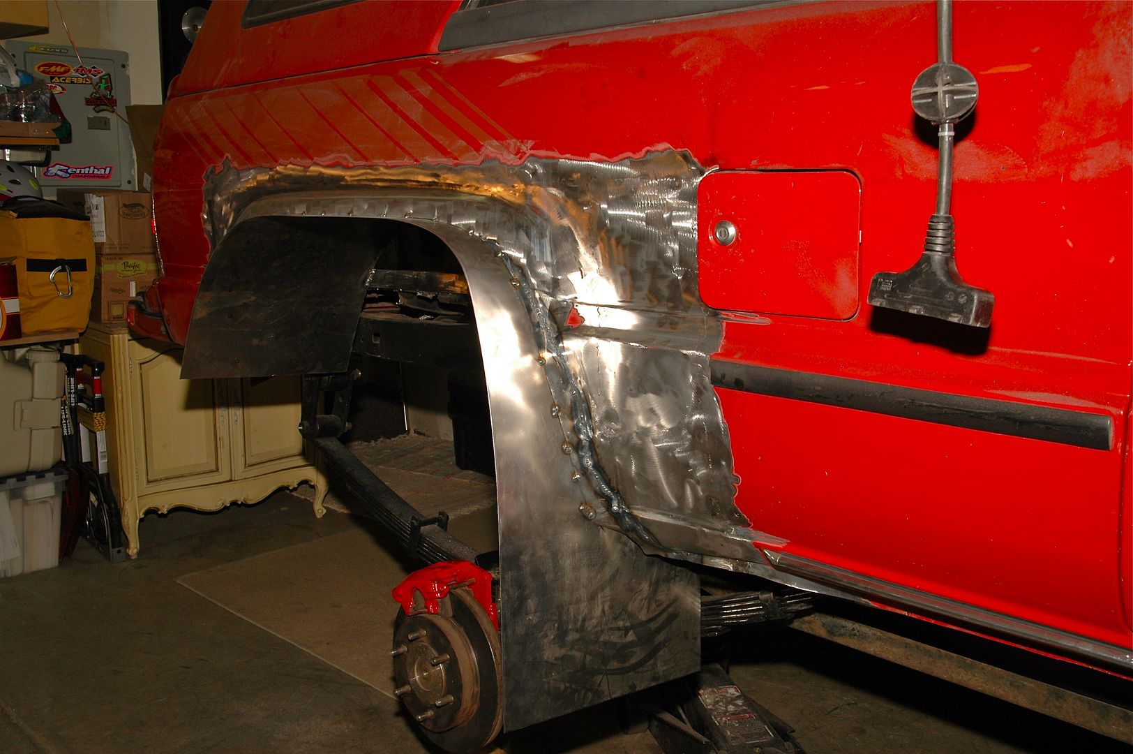

there are 3 pieces of body panel that meet inside the rear wheel well. you would need to remove all plastic, in and out, trim metal to fit your tire, then resheet the inner fender with a new sheetmetal panel.
Ive never dug into the 4th gens., but i moved the fender opening back 7" on my 1st gen. Lots of sheetmetal work. i used 20g sheet cuz it is tolerable to weld, but OEM toyota is 22g and sucks ***.
patching it in
pre finish
