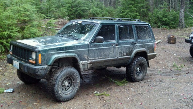

So, I got a few pennies saved up in the jeep fund, and I'm trying to figure out where to go from where it sits now.
Where it sits now: '00 xj, 4.0, auto, d30/8.25 3.55's, h&t sye, ~5" of lift, 31's that I'm planning on replacing with some duratracs later this year, stock everything except for these mods. It primarily used by my wife to haul the kids around, but we take it to play in orv parks from time to time, we're planning on a 4 or 5 day overland trip this summer, and it sees a bit of time on logging and forrest service roads taking us to play in the woods.
I am about ready to pull the trigger on a lunchbox locker for the front, but I'm beginning to rethink the priorities, which is where you folks come in.
I have been juggling whether to lock the front or rear for a while, and there are some pretty great deals right now for lockers for the front, so I was thinking that it'd be worth the gamble to find out for myself, but then I started thinking about the rest of the vehicle. No recovery points on the front(factory bumpers f/r), I don't trust the bumpers and un plated frame to take much of a hit, I want some more storage(in the form of a roof rack and or a basket\tire carrier that plugs into the receiver for now, until I trust my welding enough to make a swingout) the lighting sucks (I want to upgrade the headlight harness and get some rigid led lights) and I'm beginning to think that as often as we go out alone, that a winch would be a pretty comforting thing to have, even though it doesn't make the vehicle more capable.
So, given my situation and say a $400 budget, what would you do at this time?
