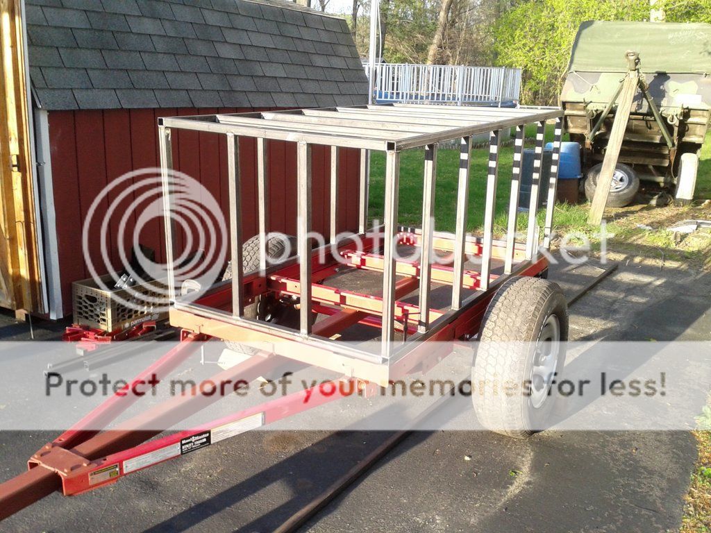

My build is winding down and I have questions and need suggestions, guess first I should show where I am at in my build
Hf 1700# trailer, deck cut down to 40" x 6' , welded
Full length spine made with received tube , welded
Box is 40"x30"x6'. 1 1/4" box 14 gauge, skin is 16 gauge steel
Jeep rims, 31" tires
This is around 1-2 weeks work
