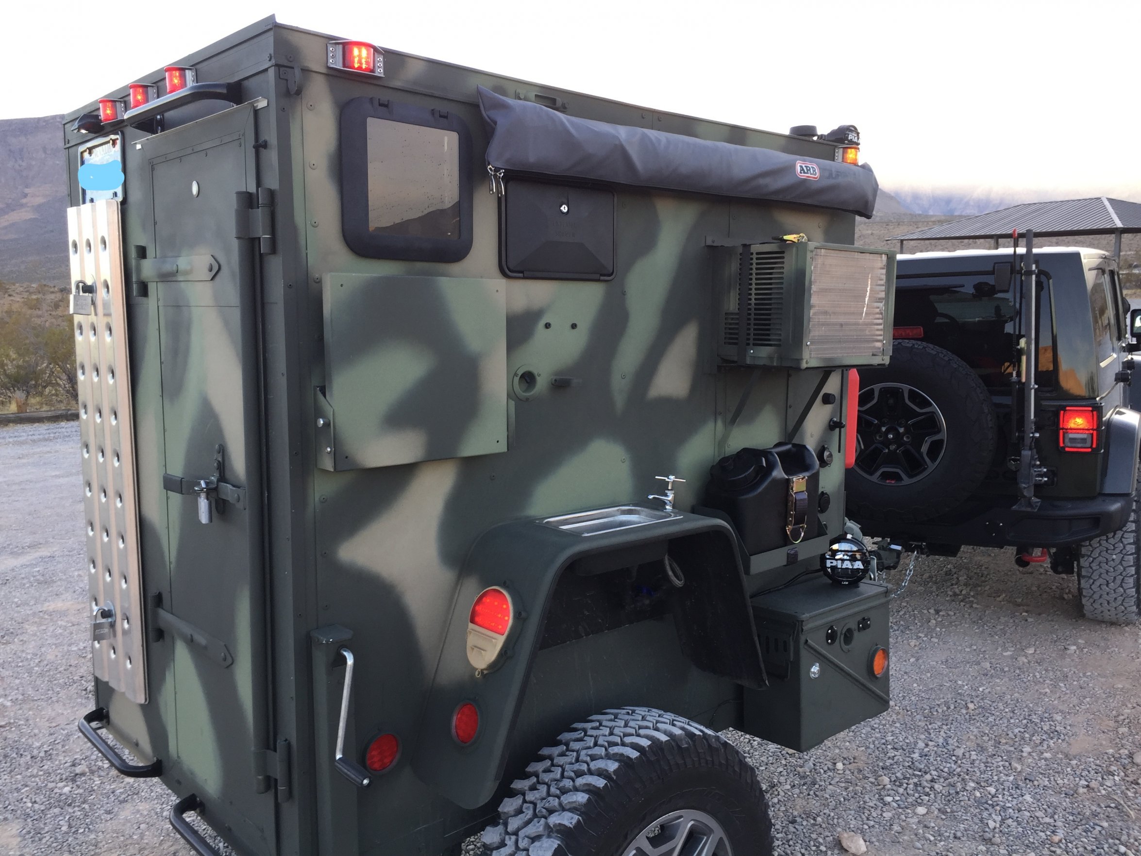

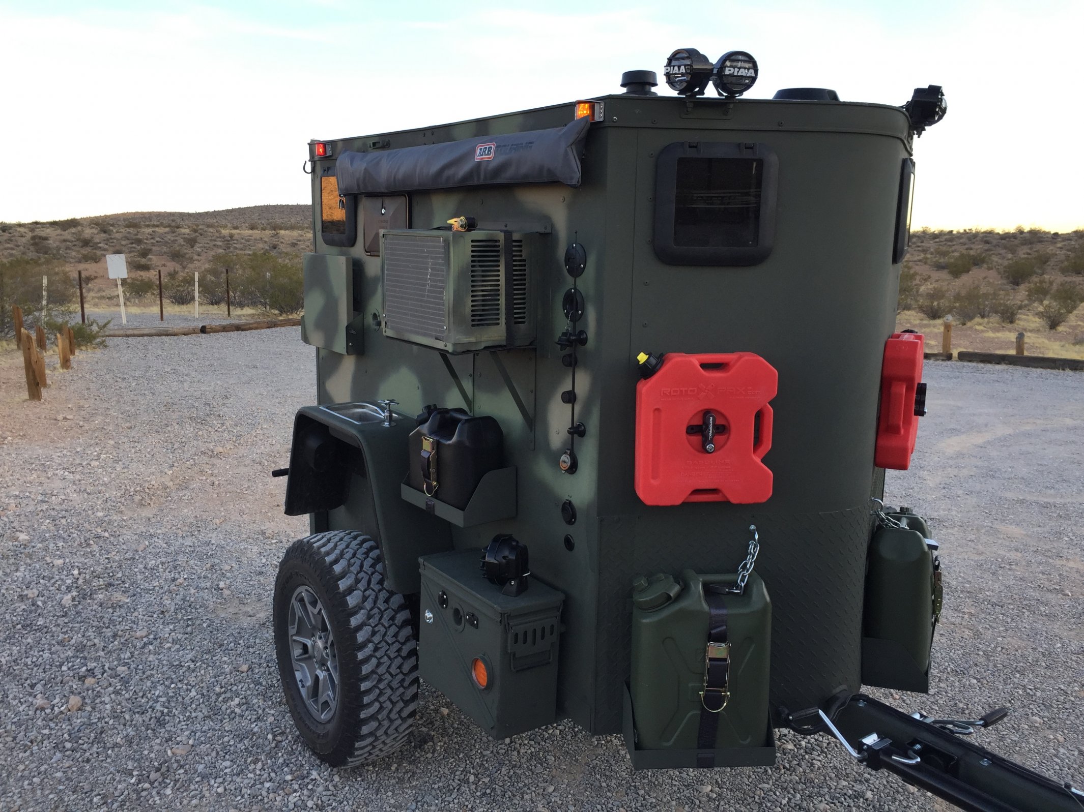

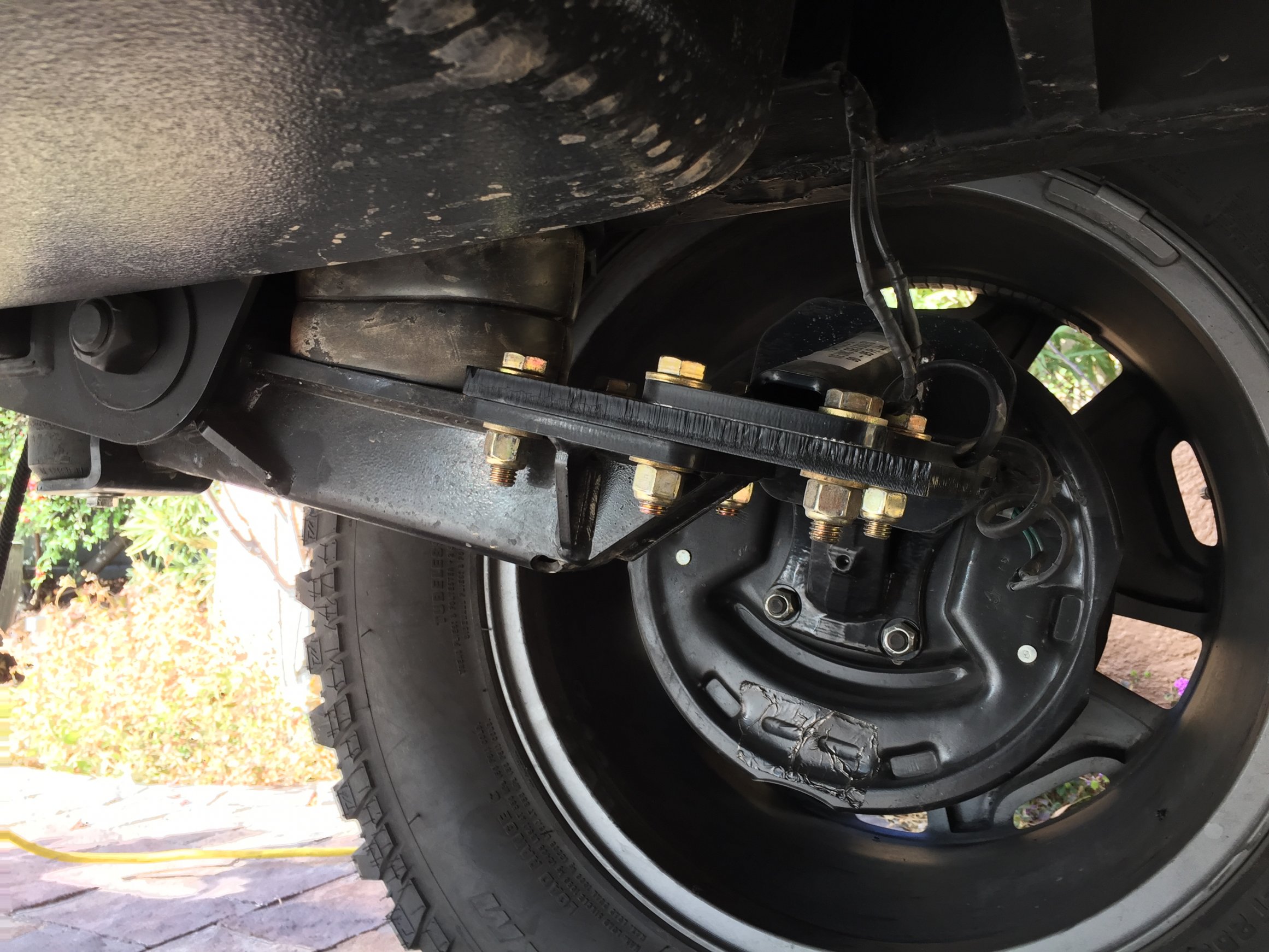

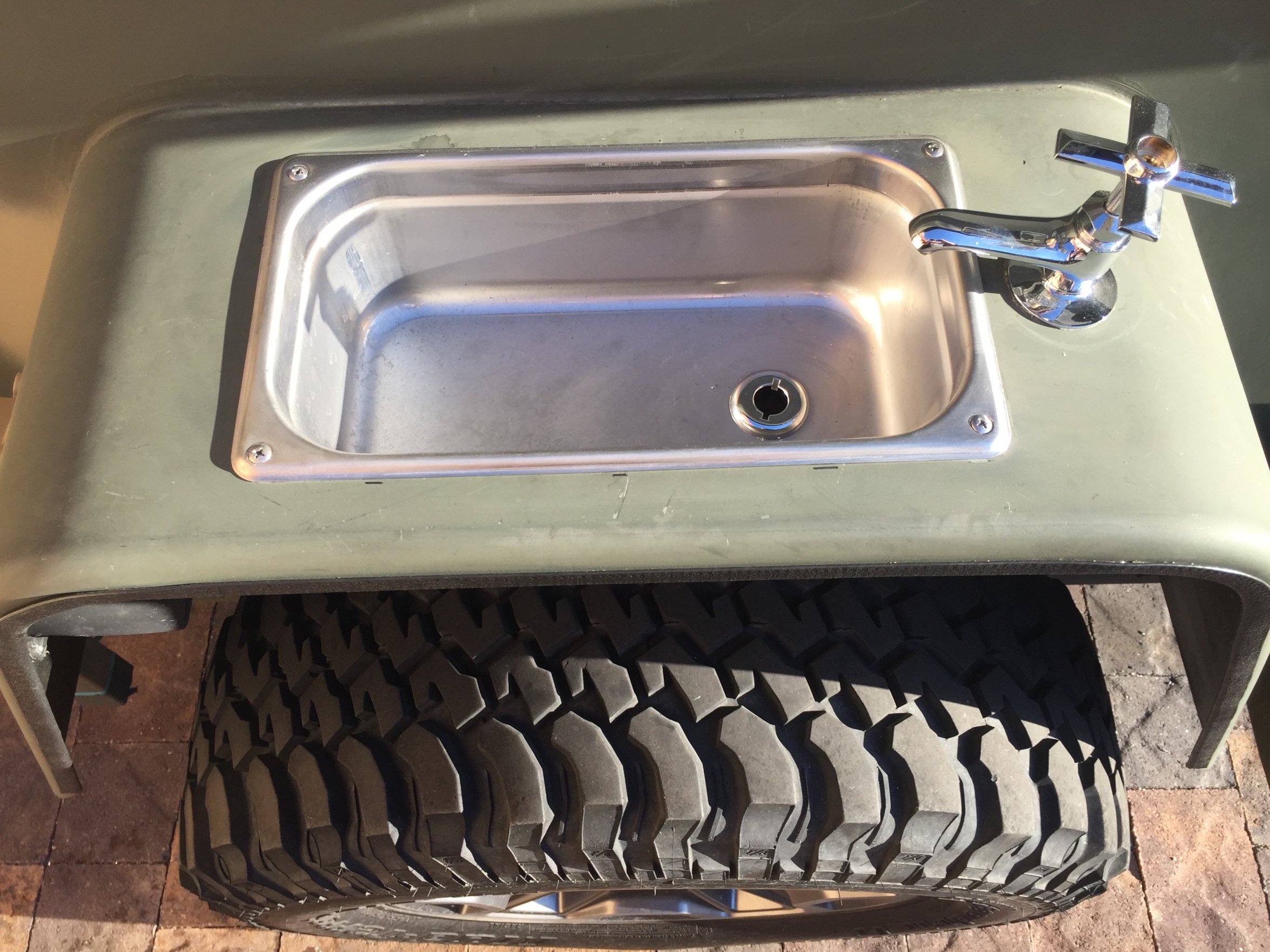

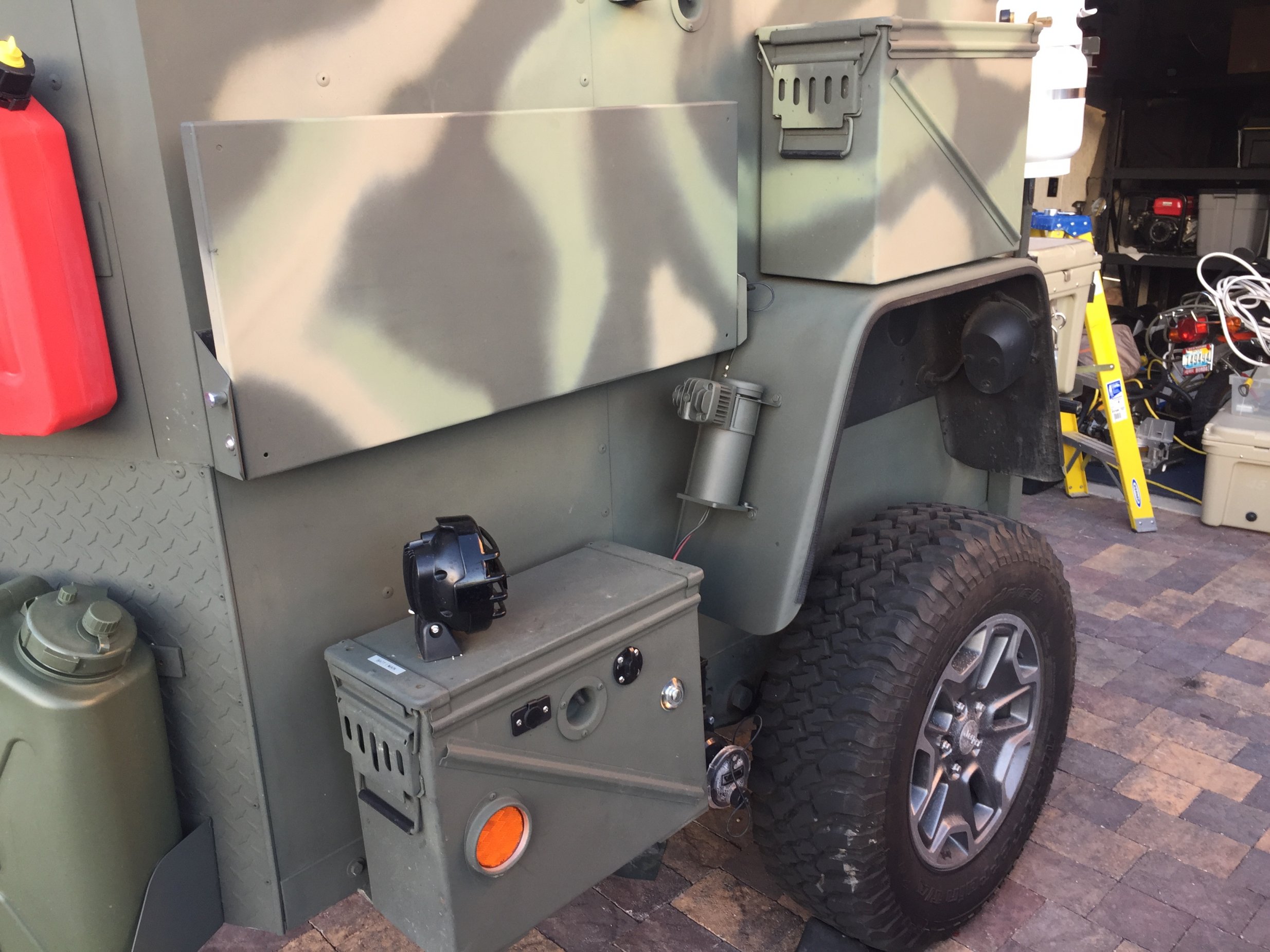

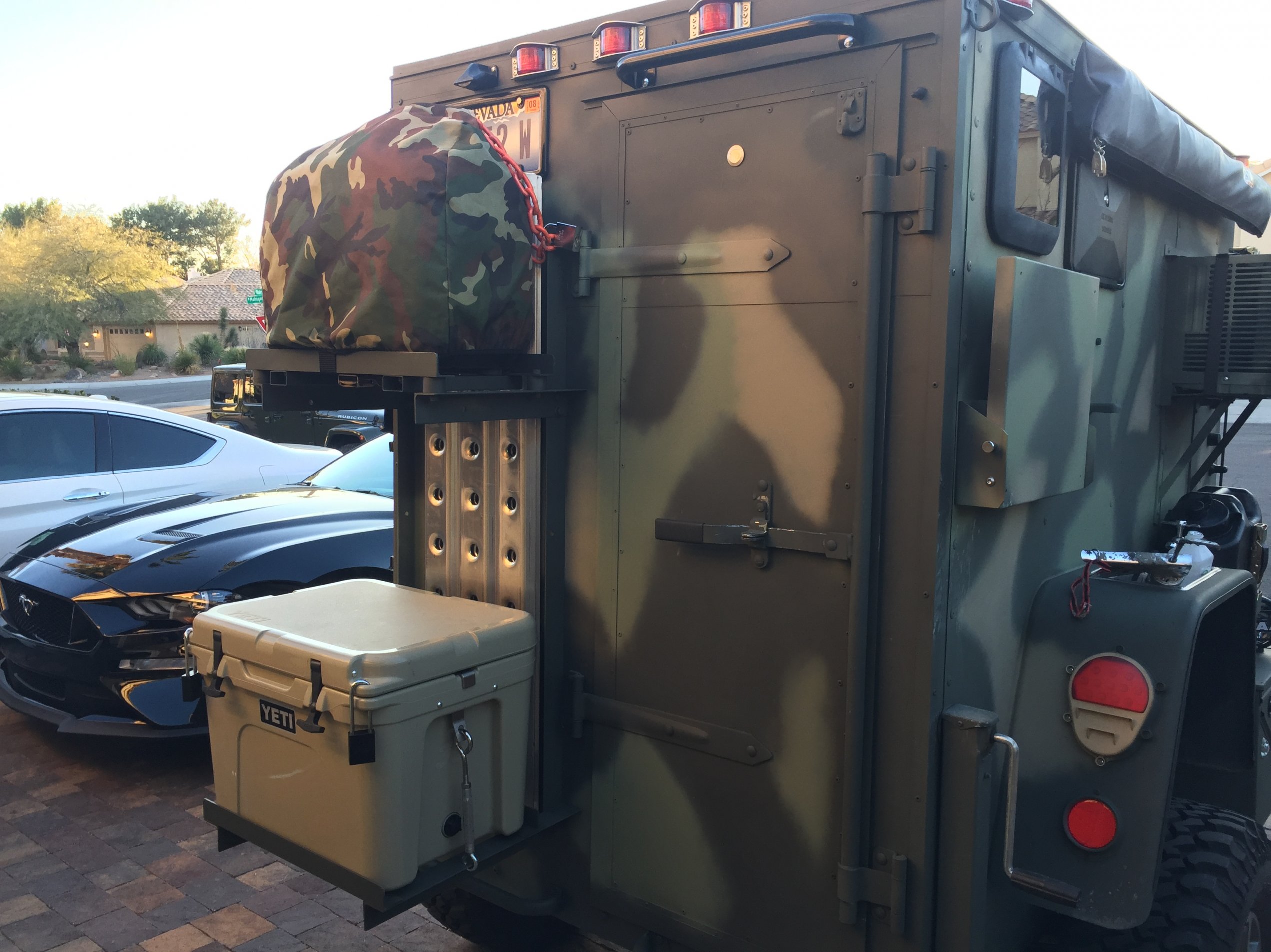

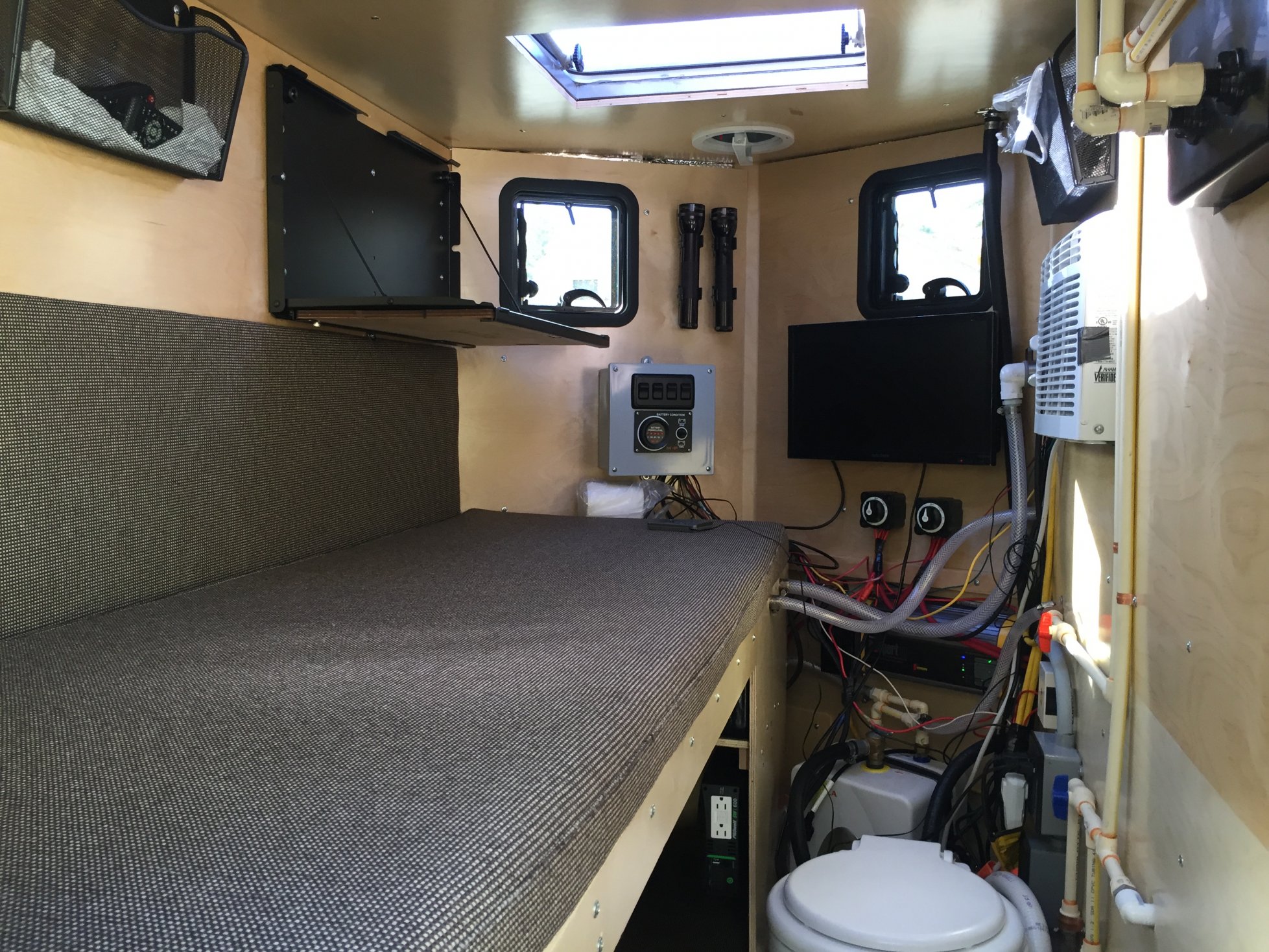

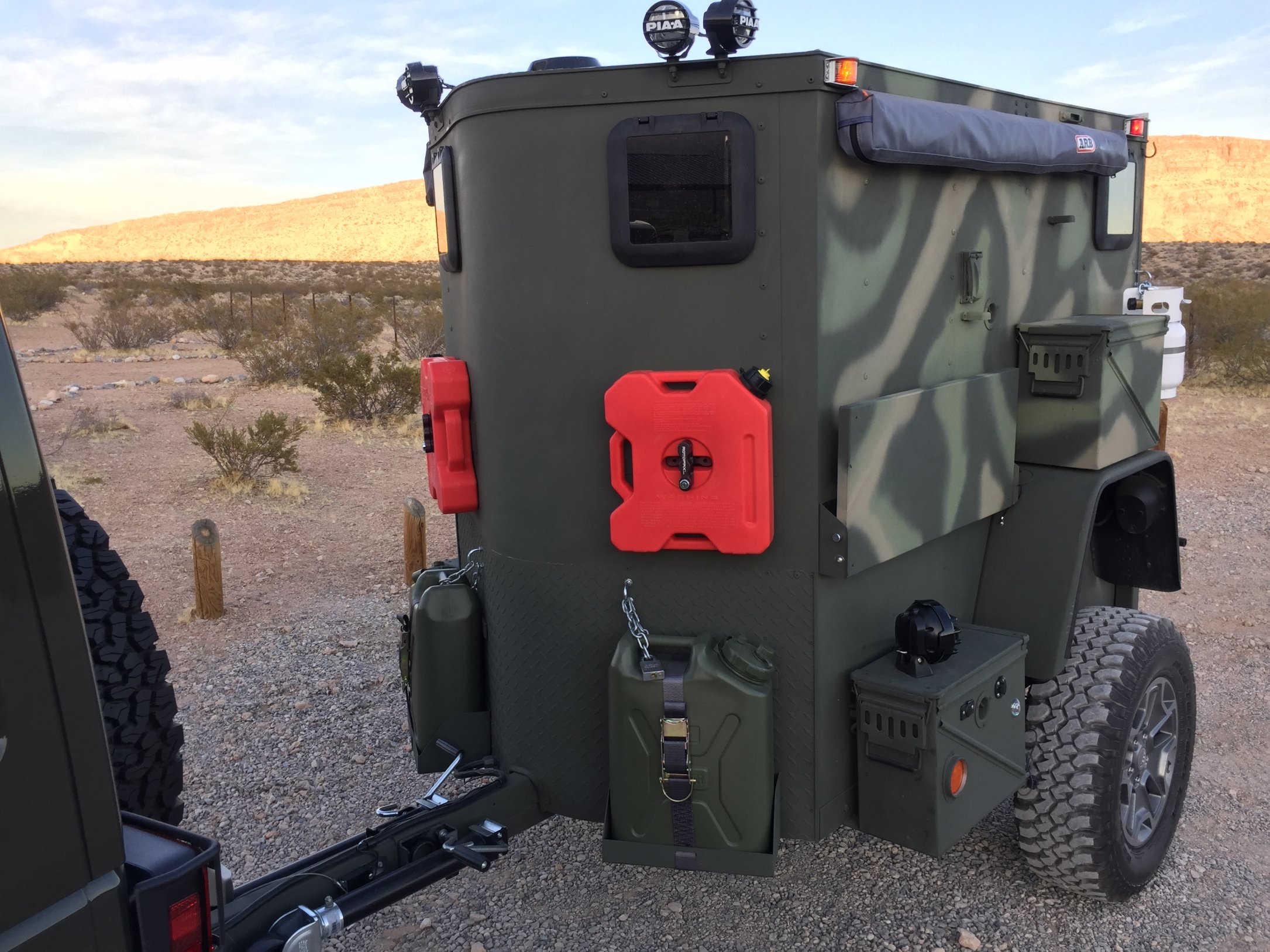

IMG_6538.jpgIMG_6523.jpgIMG_5325.jpgIMG_6615.jpgIMG_6600.jpgIMG_6462.jpgIMG_6478.jpgIMG_6450.jpgThis is my Jeep "Patton" With the "Green Beast", my homemade trailer. I hate all the set up and take down at each location so I tried to incorporate the things you must assemble to be built in or on my trailer. The result is this 50"x84"x64" box that's built on a 2"x4" 3/16" steel frame. It sleeps 2 (or 4 with the Tepui, Ayer RTT on) and a GS dog. The water tanks 24 gal (2x12) are mounted under the top bunk bed so they wont freeze, Electric marine mercratior toilet with 10 gal holding tank, H/C outside shower, 1.5 gal electric water heater (behind toilet), with Zodi gas bypass W/H. The sink is in the right fender with 8 gal holding tank, The lower ammo boxes hold 4 (2 each) Optima deep cycle batteries with built in Pro Sport marine chargers. The top ammo box holds the stove, and kitchen stuff. 160w Zamp fold out solar panels on roof. ARB awnings on both sides with the wall attachment for the shower side. Marine skylight/escape hatch on roof. Timbren HD independent suspension that gives 18" minimum GC. Straight tounge for tight turns, and the added benefit for getting things out of the back of the Jeep, nothing sticks up on the tounge so I can open the rear door all the way. 6 LED license plate lights with W/P switches to light up each work area. 4 marine port-hole windows with screens. Modified A/C for off road abuse. 3 drop down jacks for leveling or tire changing, 1 drop down wheel jack (because I hate putting the wheel on and off so that's why it has 2 front jacks. Fold down tables on both sides. 12.5 extra gallons of water in the 3 Scepter water cans. 4 gallons of gas in the 2 Rotopax for the Honda EU2000 generator Total weight 1932 LBS weighed on a truck scale. PIAA front, side, and reverse LED spot lights that can be activated from outside, inside or from the Jeep. All wiring and piping goes through marine through hull fittings for 36" of water fording And of course Jeep wheels. Since these photos all the interior trim has been finished, and window coverings from same fabric as the beds made. All the wiring has been wrapped and a satellite radio installed. Just added generator and Yeti mount.
