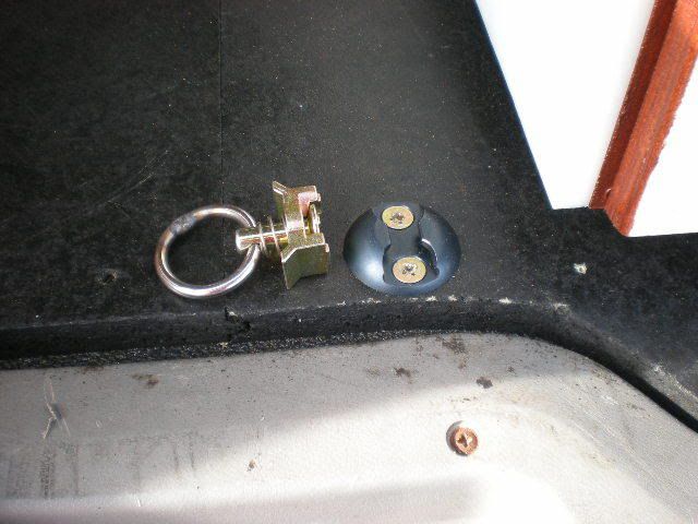

...In the pics of your Tacoma, what kind of fastener were you using to tie stuff off of? The picture isn't clear - is it something like this:
...Or did you find something readily available at a hardware store?

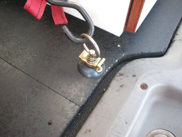

I use these to secure the camp kitchen in my Jeep. Very similar to what has been posted, but with a single base. The base of mine are hard anodized aluminum, and they came with grade 8 hardware that goes through the wood platform, and the steel floor of my Jeep. The tie downs are rated for 4000 lb vertical pull. A little over kill for most things, but its nice to know they arent going anywhere.
I bought them from a member on HERE, but he got them from this place, who also has the same version, but in the full length track style:
Yeah - I have 6 of those mounted in the bed of my Tacoma:
http://expeditionportal.com/forum/showthread.php?t=14547
But for securing loads inside the trailer, I really want to go with some sort of track system. I'm pretty sure that as my trailer evolves, the interior space will be rearranged about a trillion times once I have aux electrical power, a fridge, a shower, a water tank, etc, etc.
