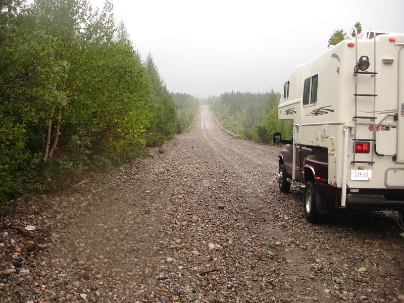

When I traveled both the roads in northern Quebec (Route Du Nord, Trans-Taiga) as well as part of the Trans-Lab highway I learned very quickly what speed was comfortable. Sure, you need to pay attention and watch the corners, grade, etc., but even traveling at 55mph I would be passed by pickup trucks and tractor trailers. Seems the people who travel these roads for a living and in longer wheel-base trucks then mine are doing 65-70 on them. I'd see a dust cloud in the rear view mirror and simply slow up a little and pull to the side. But trying to drive these roads at 30mph would be impossible.
Here's what most of the northern gravel roads I've been on look like:
Rhode Trip
I have to agree about watching your speed. The loose surface can be very slippery and the northern roads tend to be built up high for drainage. Here's a shot on the Trans Taiga:
