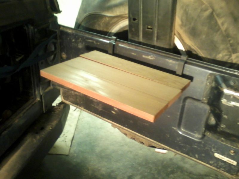

Just finished up. Turned out better than I expected and it is going to be one of the most functional things I've done my Lexus.

Awesome! That's great on the side of the drawer.
I think most used right now is a tie between it and my water system - I'm drinking water like it's going out of style!
