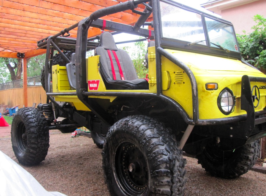

1974 UNIMOG 404 rock-crawler VIN 404114061316.
Modifications and add-on's:
-Custom Doka cab with suicide doors
-Custom roll cage with incorporated air tank
-Rhino Liner covered cab
-Custom top and taneau cover with sides and back, creating a full enclosure of the front, or running as a bikini top
-Shortened wheel base (by 8")
-Full hydraulic PSC Performance steering system with quick lock removable steering wheel
-Custom throttle-body injection w/ high compression head
-Independent pneumatically actuated front and rear lockers
-2 speed crawler gears
-Custom exhaust with a Super-Trap muffler
-Newish water pump with the safari pulley setup (better in hot environments)
-On board air, powered by a belt driven UNIMOG pump, and stored in main square loop of the roll cage
-Race Runner, remote reservoir, adjustable, rear shocks (rebuildable)
-Rancho S9000 adjustable front shocks
-Aluminum fuel cell
-USA 6x6 bead-lock wheels with Irock Super Swampers
-Master Craft front seats
-Military grade 24volt Warn 9k pound winch with military twist lock quick connector on remote and Warn quick connect power connectors front and rear allowing
the unit to be mounted front or rear
This Mog is stored inside all of the time (except for the sneaky rain storm that hit as I was taking pictures ;-). I have owned it for almost four years now and have done Moab, Las Cruses and local trails many times, never with any mechanical difficulties. She is a very reliable turn-key rock crawler. This UNIMOG is iconic to anyone who has searched "UNIMOG" on YouTube. It was built by, well known and respected UNIMOG dealer, Rob Pickering.
