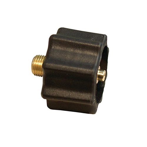

I bought a 10lb ignik propane growler. according to ignik there connection on their hose is a: inlet 0.5 inch QCC1. (and outlet is 1 inch 20UNEF)
I dont know what connection partner stove uses. But what I need an adapter that hooks to the partner stove hose so I can connect it to the growler
Any help would be greatly appreciated. I ordered partner stoves adapter but that convert their hose to work with 1 pount disposable bottles. Ordered another adapter on amazon but it was completely wrong.
Pulling my hair out. Thanks for any help
drpete12
here are photos of the connections. Just want to make sure the adapter posted above will work. thanks again
first pic is connector on growler, second (middle) is the connector on the stove and the last if the other end of the hose that came with stove that should hook to a tank.

Is that Ignik valve not just a standard one you find on any large propane tank? The Partner Steel hose fitting for the tank should simply thread to the INTERIOR threads of the tank valve. It's reverse-threaded (i.e. left-tighty). I've used my Partner Steel with standard 5, 10/11, 20 and 30-lb propane canisters with zero issues.
