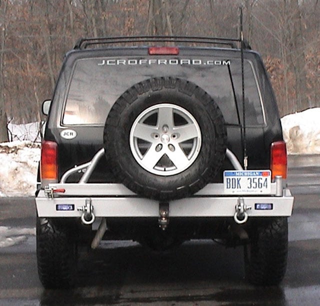

This bumper, from JCR OffRoad, $625 not including the built-in lights:

If you've got a friend that does custom fabrication, he could probably fab you up an identical looking bumper for 1/3 the cost of that Garvin one.
