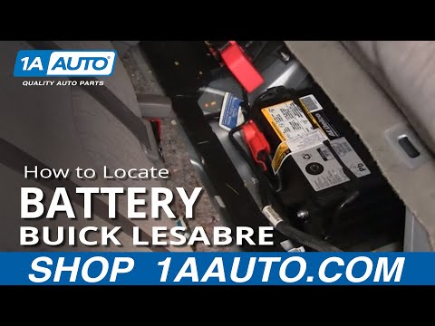

Car makers for decades had the UNsealed wet lead acid batteries inside the passenger compartment of many vehicles. Both American and European. Some pickups. Volkswagon Beetles had it under the back seat. The 2002 Buick LeSabre has it under the back seat.

And if you are worried about hydrogen gas the LAST thing you would want to do is seal the battery up tight in a box. Engineers work hard to seal the lines of hydrogen fuel cell systems. It's the smallest atom there is. It wont have ANY trouble getting out of your vehicle. And that's only if you have a fault condition in the first place. You folks need to understand the vast difference between possible and probable.
