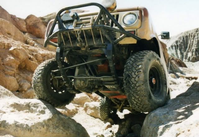

Are you familiar with the various moisture curing polyurethane paints like POR-15 or Rust Bullet? There are commercial such paints, but those two and their like are the easiest for the home hobbyist to get. Given how Scouts and all IH's rust like that is their primary function in life I would invest heavily in a paint of this type for all of those hard to reach nooks and crannies.
This Scout II has about 15 gallons of POR on it. I'm serious, all of the black visible is POR or POR that has been top coated. The owner is just a tiny bit anal.....
btw, that Scout is known as the "Harvester of Sorrow" or "Harvey" for short.
