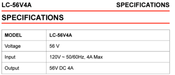

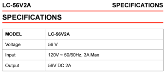

I am considering the ECHO DCS-5000 (56 Vdc) with a 5.0 Ah battery so I guess I am at 280 Wh?
As you can tell from above - I am blind when it comes to electrical issues so please feel free to help me answer this question prior to me purchasing an inverter. Thank you!
From Echo Operator’s Manuals for input watts
Echo 'regular charger' (360 watts @ 120vac)
Echo 'fast charger' (480 watts @ 120vac)
