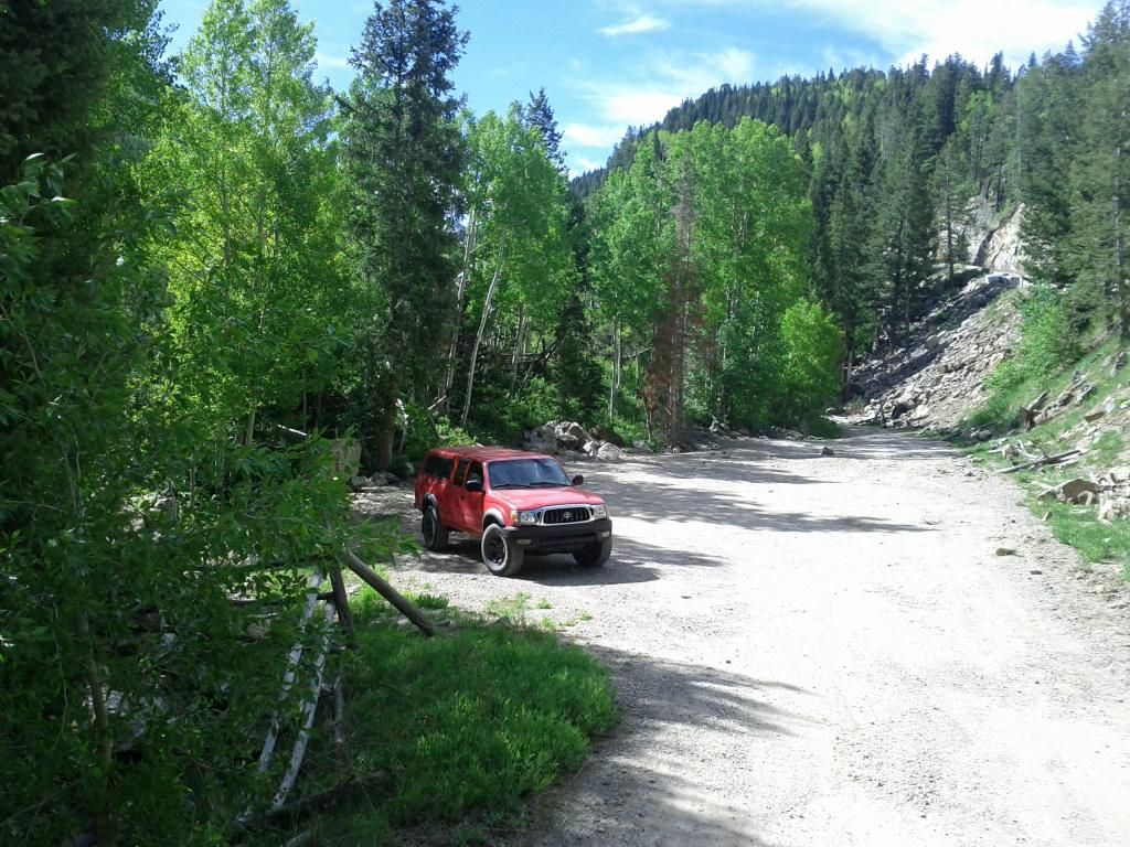

I have been mostly sucking up info from this site for years, but not contributing much. Lazy I guess. Anyway, I have a bit of a weird truck that I thought I would share. It has been a headache from the very start, but it is fun and gets me where I want to go. I had always wanted a diesel Toyota, but as you know our options are limited. I had a 1965 FJ40 for a bit and loved it, but wanted a bit more space and really wanted a truck. I considered a BJ74, as they are such an awesome vehicle as well as semi-available to import, but again, space. I settled on doing a 1kz-te swap into a 1st gen Tacoma, and got to looking for a donor Taco. One day, I discovered a Cragslist ad up the road from me with a truck already swapped with this engine, but due to issues the owner couldn't figure out, he was selling it for a sweet price. I had done so much reading about the swap and the engine in general, I figured that for the price, I could figure anything out. Fast forward 3 years or so, and I never knew one truck could have had so much wrong with it. I have replaced or rebuilt nearly every component on this truck and still have a few more kinks to work out.
I do however always try to improve something while fixing what was broken, and due to having to fix everything, there are a few fun goodies now.
