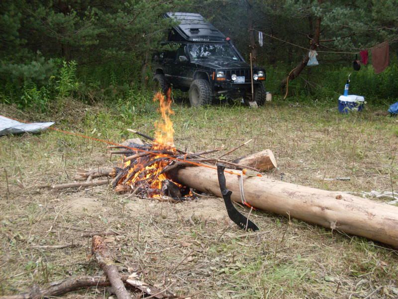

This will be a real issue. How's the black one above holding up? As mentioned, XJ's aren't exactly sturdy unibodies to begin with. Cutting the roof out isn't going to help.

Not sure if you saw the whole thread (it's worth it), the guy put a roll cage from a 4Runner into the XJ (fit perfectly) and he's had no problems at all.
Full flexed, all the doors opened and closed without a problem.

As we were building XJ's, we'd reinforce some area and stress would transfer to another area creating fatigue cracks at areas we hadn't addressed. It was an interesting process. (oddly enough, two of my three Jeeps have frames now...the other is a hooptymobile for my 16 yr. old to drive to school (ZJ))
Good deal that it's working for him! Definitely a cool concept
