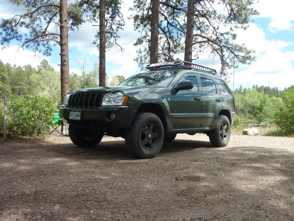

There are advantages to both vehicles....the JK/JKU are great vehicles and if I did not have the WK diesel I would be in the Wrangler...check out my build in the link below.
