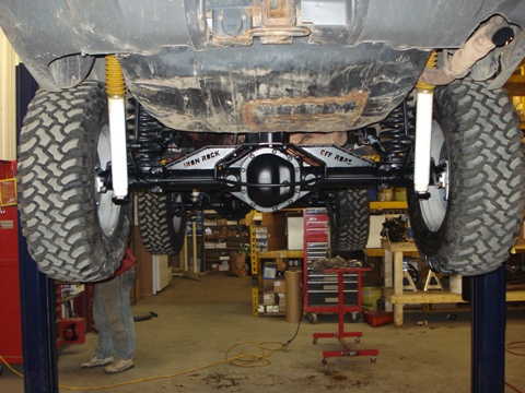

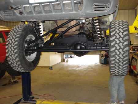

Front axle:
http://www.ironrockoffroad.com/Merchant2/merchant.mvc?Screen=PROD&Store_Code=IROR&Product_Code=IR-WJKFA
Rear axle:
http://www.ironrockoffroad.com/Merchant2/merchant.mvc?Screen=PROD&Store_Code=IROR&Product_Code=IR-WJKRA
Spendy conversion...but axles are never cheap. On the plus side, you've getting a trussed JK 44. Throw in a set of sleeves in the front, gusset the C's, and some chromo shafts and you'll be ready to run 37's...or keep it at 35's and your axles will last a long time, even under abusive conditions.
