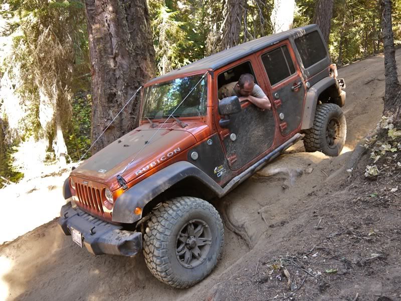

We have the 2.5XT, brackets, and 33" AT's on our '12 JKUR precisely because of it's combination of on road and off road manners.
It drives way better than stock on the street - no brake dive, no bump steer, crisp handling in avoidence manuvers, yet it takes on the typical overlanding type trails with ease. It's my wife's daily driver, and it's also taking on the majority of our weekend fun that the Power Wagon used to do. Getting that extra 6 mpg sure makes a difference, and the Jeep is almost as capable as the big truck.
We had it thru basket ball size mesa top bloulders with no problems as far as the brackets go. Typical AZ washboard roads are smooth as glass - the perfectly matched shocks and coils flat out work. By sticking with a 33" tire, we avoid all the known axle issues, and the punkin' clearance is still very good. Obviously, it's way better than my Power Wagon on 35's due to the difference in the axles, so for me, it's really easy to get thru stuff.
Not adding weight was and is a priority, so after looking at a lot of front bumper I settled on the LoD Armor Lite - nice steel bumper that only weighs 31 lbs. When funds allow, I'm looking for an aluminum rear bumper.
