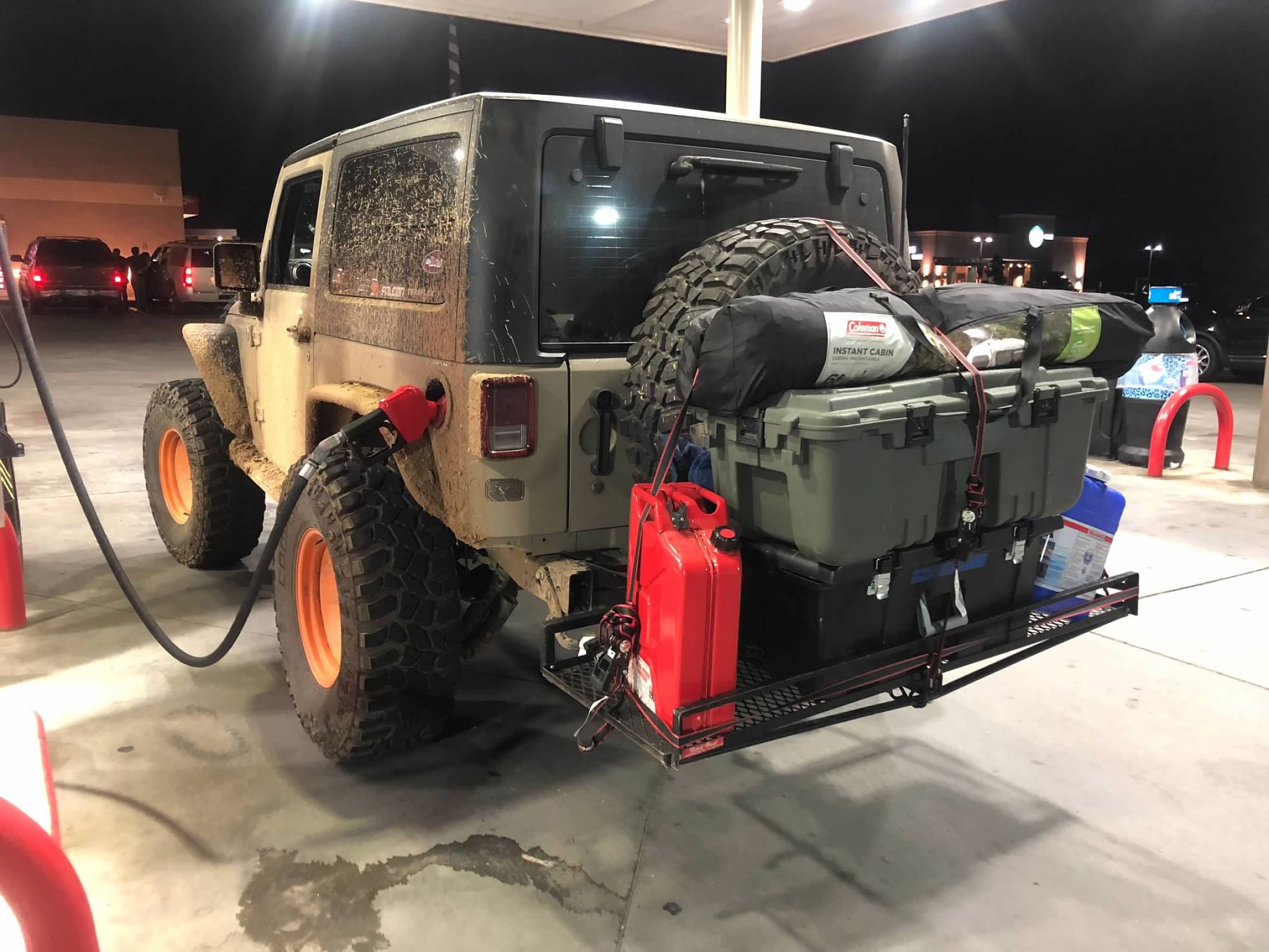

I bought the jeep used and there are no indication anywhere on what lift it is. It’s not spacers, that’s about as much as i know. It already seems like the rear sags a bit though.
The sagging is because the Einsteins all want a ‘level’ jeep with no rake hence all the dumb *** leveling kits and most lifts ‘level’ the vehicle. Until you put a bag of groceries in the back and the rear is sagging.
This is 150% correct, unless it’s a mall crawler. Any vehicle built to load for camping/expedition use should have a rake when unloaded. It might not have that look that people prefer but it’s correct for it’s use. I see a lot of droop in trucks and suvs that are loaded because of incorrect spring rates and leveling kits.
