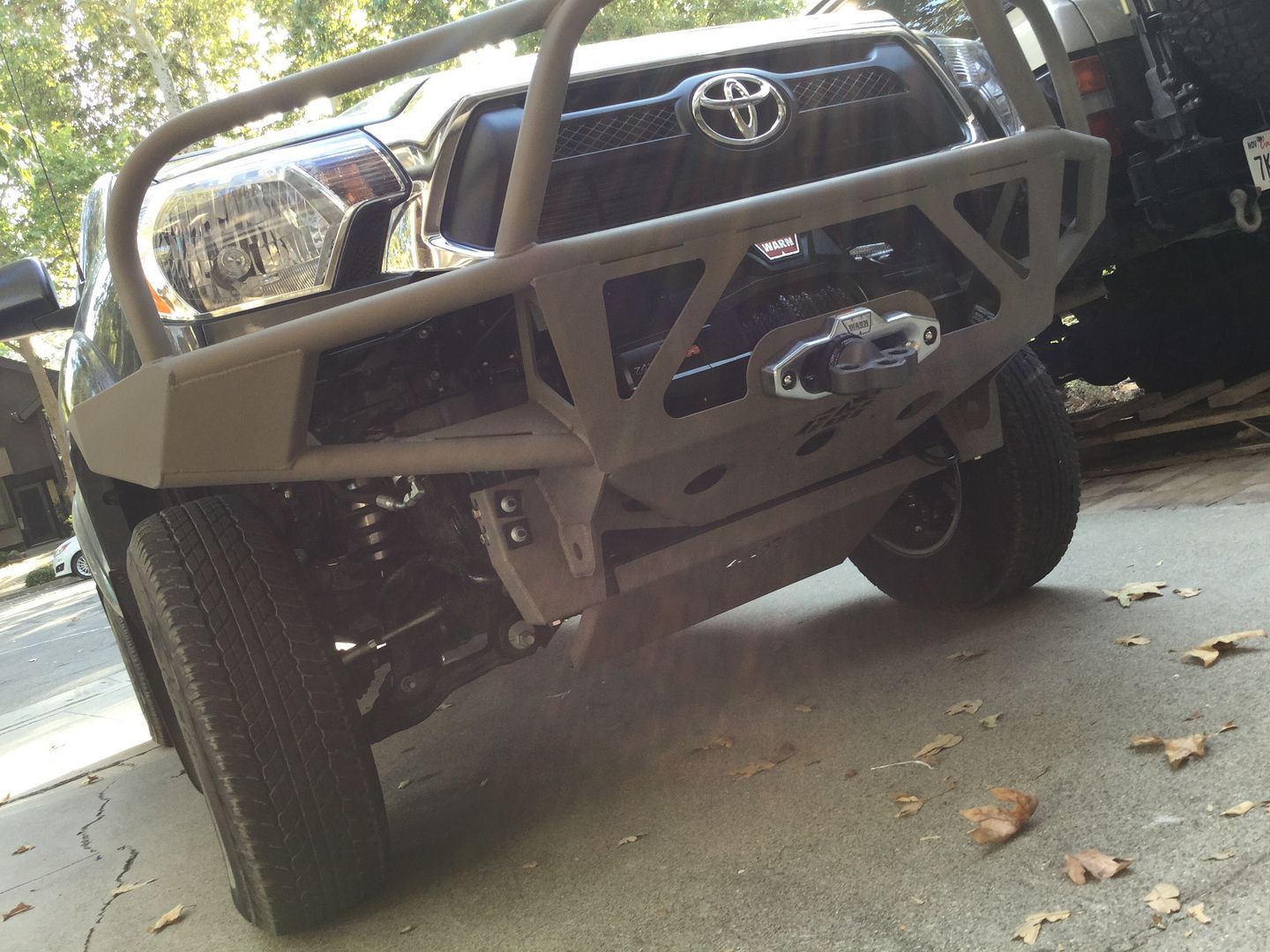

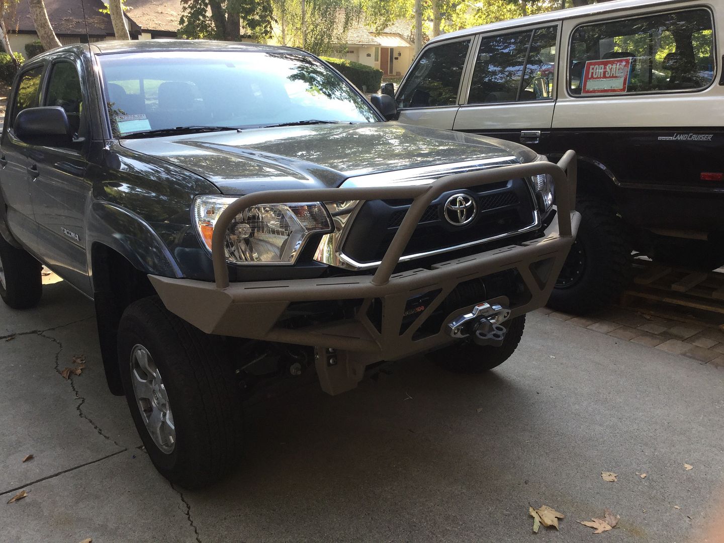

Plugging away, CBI front bumper, skid plates, rock sliders all painted up with air cure Cerakote. Warn 10s winch.

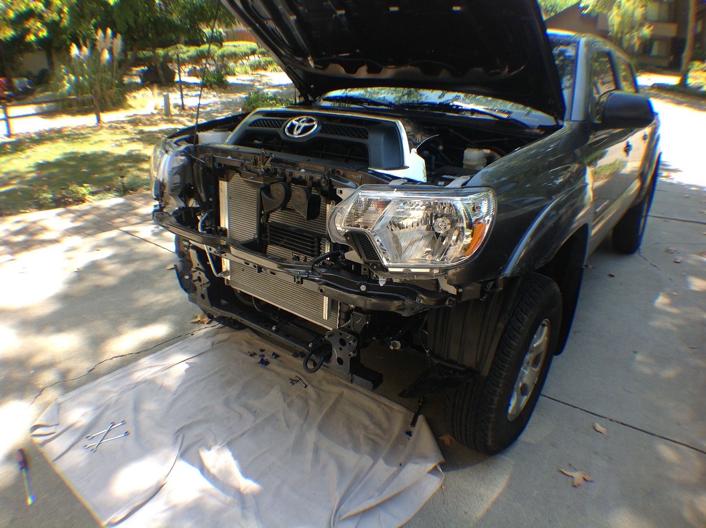

Front end taken off
And all mounted up
And the first part of the skid plate
For the most part, it all went together pretty well, I had a momentary panic attack when the sway bar rubbed on the lower bumper sub frame braces. Between the Icon sway bar relocation blocks, the added thickness of the reservoir brackets and the bumper brackets, the sway bar was rubbing a fair amount. But once the braces were removed and the skid plate was installed, no rubbing.

Danimal
You're just going to work on the new hotness and take pictures of it right there in front of the 60 series with the For Sale sign on it? Cold blooded gangster.
Anyway, it looks awesome, you're off to one helluva start.
