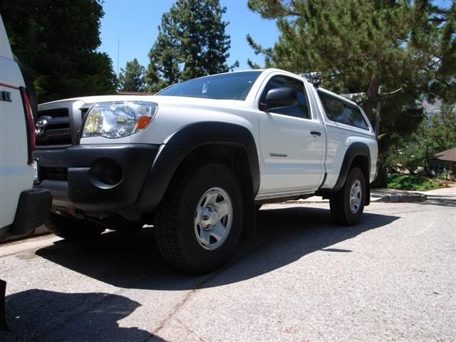

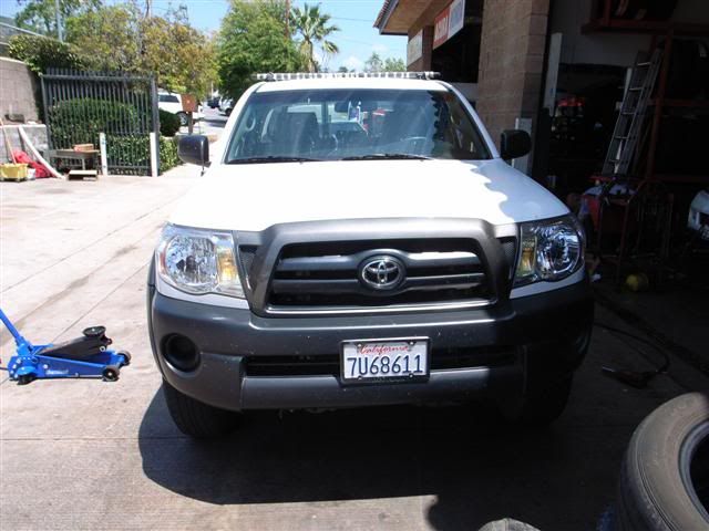

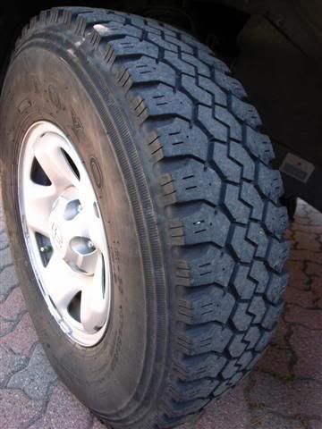

New Shoes - Toyo M-55
I found a really good deal on craigslist for 235/85/16's.. set of 4 for $150. They came off a Ford f250 powerstroke, still plenty of tread left.
$50 to mount & balance = $200 total said and done
These are Toyo M-55, an industrial/commercial 10ply E rated tire. There's a bit of a hum, but that's common with most aggressive tread tires (so I read).
These are also my first time driving with E rated tires, but it's too soon to have any opinions.
On to the pictures!
^Solution to Taco-lean - 32" tires on the driver side, stock 30.5's on the passenger :elkgrin:
At first, I thought I had a bit of rubbing at full lock, but after looking around the wheel well, there is plenty of clearance.
