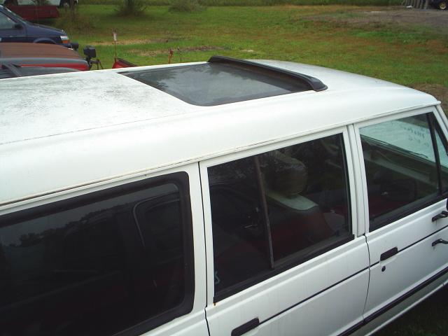

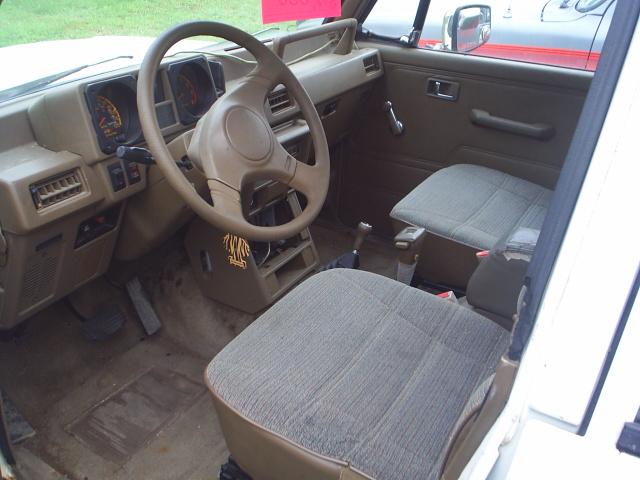

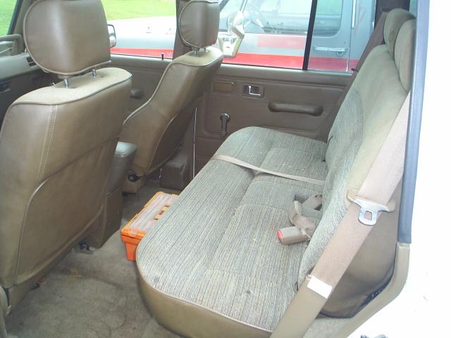

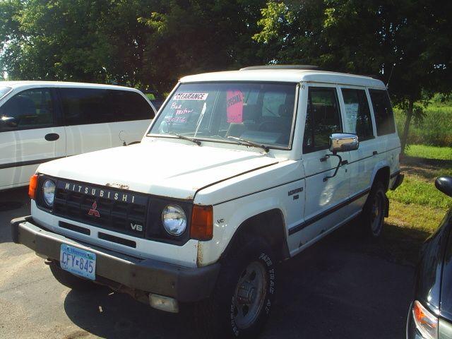

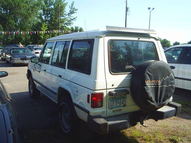

I have been struggling to figure out if I want to build my ExPo rig out of my '05 Liberty CRD, or '99 Cherokee.... till I stumbled across a 91 Monty LS with a bad motor locally. The dealer is listing it as a 106k old truck with no dents and "some rust". I live in MN, but from CA, so "some rust" scares the hell out of me. The motor was pulled apart by some fool, and abandoned.
Here are the listing pics...
They are asking $400 for the rig, and I am VERY tempted.
