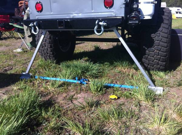

What about using something like this? You'll have to add a round piece of steel to mount, but could then spin the jack out of the way while traveling.

I use ones like this as well
They work really well. The only downside is they take up space inside the trailer.
