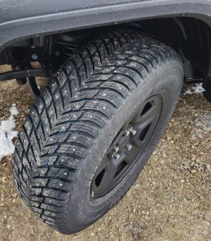

@AggieOE I have run dedicated studded snow tires for the last 25 years.
We have more ice than snow in this part of Ohio.
It snows a little, it half way melts during the day then the wet areas freeze over night - just in time for my morning commute.
So that opens up my tire choices, do I run a solid AT with decent wet traction and less hit to my mpg or do I go full MT?
Logic would suggest a nice AT but who wouldn't want full on muddies?

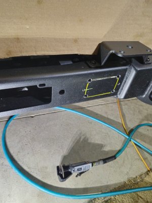

Trailer tow lighting kit install

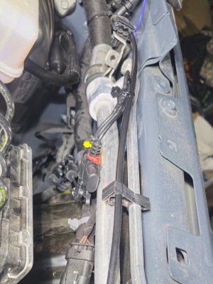

When I purchased the trailer hitch receiver I also ordered the Mopar wiring for trailer lights.
There are several good YouTube videos showing how to install the kit, one from Quadratec, that were made around the time the JL was released.
However the installation has been changed since then and I did not find much on line that touched on this.
The parts behind the rear axle and in front of the front axle are not changed.
But getting the wires from the back to the front is changed.
In the old kit the interior trim on the right side is removed and the wires are run inside the cabin.
On the new kit the wires are zip tied to a harness that runs underneath along the top of the frame rail.
However the harness is on the inside top of the frame, the gas tank blocks access from the inside and the body is too close to the frame for my fat fingers to access it.
Apparently the diesel has a fuel line that runs on the outside of the frame and looks easy to access.

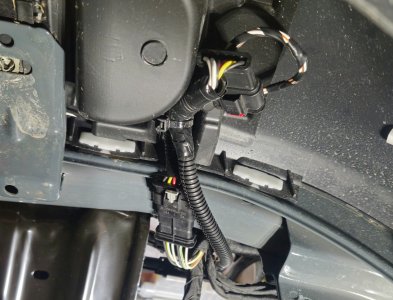

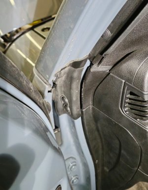

Photo shows the gap where the harness lives, you can see the trailer lighting wires and a zip tie.
After fixing the wires under the hood and down in the right front wheel well I started to fix the run along the frame.
I struggled with the first couple of zip ties only managing to snag the existing harness if it looped out close to the outside edge of the frame.
This was one of the first zip ties added, I managed to get the trailer wire harness in the wrong way around but the battle was won so I left it.
Finally I hit on the idea of using a length of aluminum welding rod for an oxy-acetylene torch.
This rod (think wire) was soft and easy to bend, I could put a bend in it, fish it behind both wires, attach a zip tie and then pull the welding rod back out.
The aluminum would flex and draw the zip tie around the wires.
In the picture you can see the aluminum is pretty janky being drawn out looped over the wire harness.
I tried to grab the end of the zip tie before releasing the aluminum wire, lost the battle a few times before I started doing this.
A side note, the VIN is a dot matrix stamping on the frame.
For reasons the VIN gets stamped in after the painting, my employer dose several things to slow the rust, wipe heavy grease in it, paint it with clear.
Jeep slaps a thick clear tape over the raw metal.
After this picture was taken I peeled the tape and painted it with clear coat.
Pic of the installed hitch and trailer light plug.

I ordered the BesTop soft doors and the Quadratec quick release mirrors.
The mirrors are a quick bolt on solution, and I assumed I would need to revisit mirrors in the future.
Near future as it turns out.
The door install required a little adjusting, bending and prying.
After my initial adjustment I took it on the interstate doing 75 mph, the tops of the window frames pulled away from the door frames about an inch, more with heavy cross winds.
And the mirrors folded back despite having turned the thumb screw pretty hard.
So, another round of adjustments.
I did a search on YouTube, there are a lot of videos whining about the doors leaking (I’m guessing they do leak) but only a few that I found useful.
BesTop has a how to install video, this one was the most useful.
In it they show just a glimpse of bending the frame to adjust the sealing of the top.
A quick screen shot:
You can see that they are serious about “adjusting” the door.
My upper window frame contacts the door frame first by a good margin, I adjusted it a few times until the window frame was pushing the rubber seal on the door frame out of position, then I backed it off just a little.
I don’t want to damage the seals for the hard doors.
You can see the angle the door is at with the top front of the window frame just touching the door frame.
After tweaking the window frame I needed to adjust the door again so the latch striker hit the bail just right, a little push and the door latches.
I also swapped out thumb screw on the mirrors and dropped in a bolt.
Even with the bolt holding the mirrors in position and turning them 90* to be wider, they are in the wrong position to be useful, in the picture you can just see a sliver of mirror with major distortion from the soft plastic window.
I have some other ideas that will take a little time, these will do for now.
On the second test drive the tops of the windows stayed in contact with the door frame and the mirrors stayed put.
So for the return trip I dropped the top and pulled the doors off for the full effect:
It’s supposed to rain in the afternoon tomorrow so that will be the real test.
So far I’m pretty happy with the set up.
