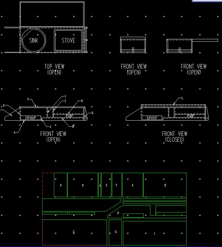

Here is a CAD drawing of what I think mine will look like. Has a sink and stove permanently mounted and three small drawers. The wings on the left side are just so I can slide it out further without interfering with the propane tank when everything is stored away.
Don
