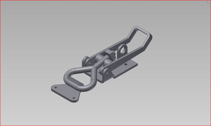

Im looking for a set of locking lid latches. I found some destaco ones but they dont have provisions for a pad lock.
looking for similar to these
like this one i found a cad drawing of.
