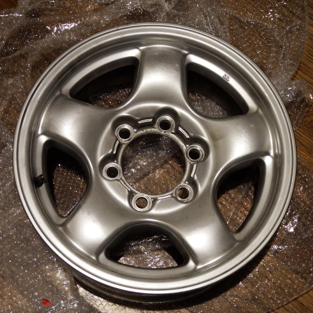

good evening,

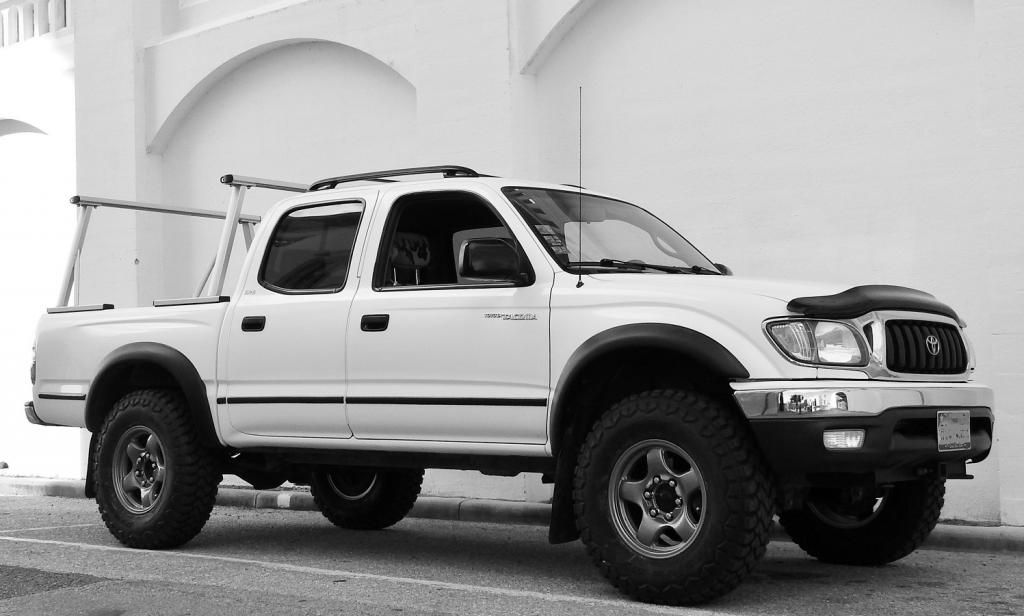

long time stalker here. I have a 2004 3RZ double cab tacoma that's a bit on the sluggish side to say the least. after much research and a recent sale I picked up some 235/85/16 cooper at3s that weigh in at about 41lb a piece. I'm now trying to figure out what 16x7 wheels could be a good match for this tire. I'm looking at alloys. Seems like the outback tx-1s would have been a good match but no longer available in the US. I like the SCS F5 at 19lb but they only come in a 16x8. So I'm looking towards stock toyota wheels over the years and poring over pages of forum results trying to find some weights for them. I'm also hoping to find a bit less backspacing than the 4.5" stock to keep the stance reasonable. This rules out the newer tacoma wheels which would require spacers, a route I'm hoping to avoid for various reasons. Some of the FJ wheels seem to be close; but I can't find a weight for the 5 spoke all-terrain package wheels and the 6-spoke trd ones seem to be about 29 lbs. I've also seen some mention the older three-spoke 4runner wheels in a 16x7 are under 20lbs but info seems sketchy.
Right now I have toyota steelies and 265/75/16 revo2s if anyone is wondering.
Any suggestions as to what light 16x7 might be out there are appreciated.
Thanks
Nick

Pretty sure the stock 01-04 star style 4.5" BS tacoma rims are around 24 lbs.
Split 3 spoke 16x7 rims are 22.2 lbs (internet)
Flowery 01-02 4runner limited rims are 22.5 lbs. (internet)
My FZJ80 16x8 4.5" BS rims are 21 lbs.

I found a set of these a while back 16X7" a little less than 20lbs it's a factory Toyota wheel off of a 4runner I think it was called a chrome edition? I am also running 235/85/16 tires on my Taco since these DC trucks are not exactly rocket ships...

dude, that's money. this is exactly the info I was hoping for; there does exist a holy grail of oem toyota truck wheels!
I ended up picking up some refurbished 5-spoke FJ wheels, which weigh 22.5lbs on my scale. I'll throw up some pics once I get them mounted on the truck.
Speaking of re-gearing, already running 5.29s. I just saw the chance to help the truck out some and every little bit helps. A trip to the dump last week and I was at 4300 lbs on their scales. 40lbs less at the wheels would be a welcome improvement!
Thanks for all the help, gentlemen
