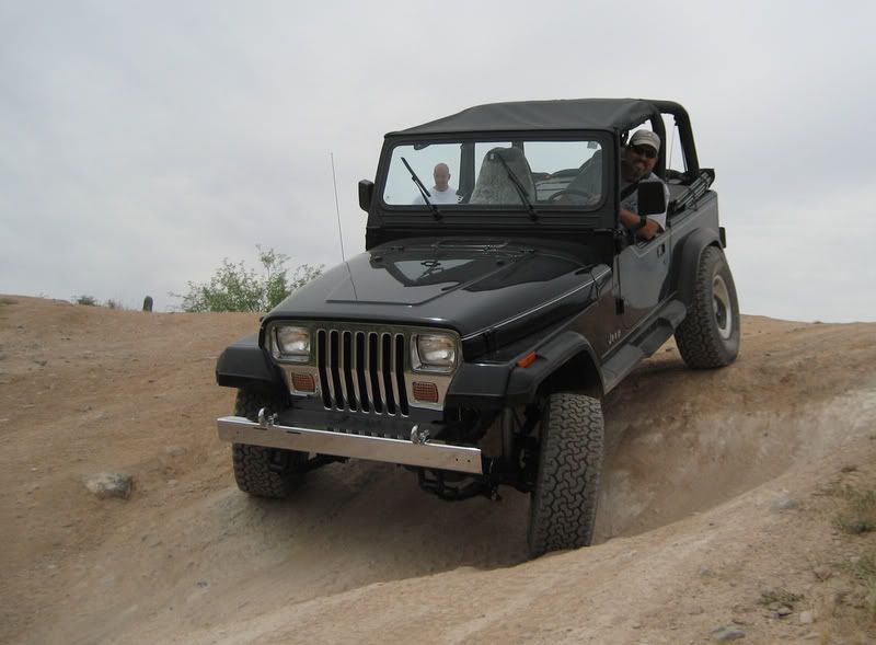

Here is a couple of shots of mine. One with a roof top tent that I used all summer one year for bike racing. Very comfortable, and I was able to install myself.
this is what it looks like now
