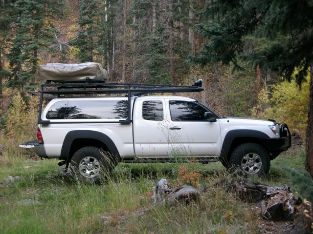

I was searching around the forum and came across this thread so I thought a pic of my rig was in order for future searchers. I went with Line X after looking at it and Rhino finished products. Rhino can get a milky color when wet. The Line X is easy to care for and always looks great. I did the flares only:
deadbeat son
Your Tacoma looks pretty good with the Line-Xed flares. Did you have it done in Denver? (I recall seeing one place near Larimer and Park Ave.) How long ago did you have the Line-X applied?
