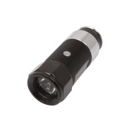

Tiny rechargeable cig-lighter socket mini flashlight, 30 lumen, 3 modes, direct from China. The shipping cost $2.49, the light was cheaper. Several weeks in and it is working real nice. Hasn't burned my Sub to the ground yet.
That's it on the left, smaller than a 'C' battery -
