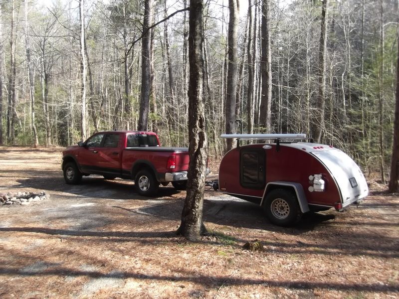

New Little Guy owner here - with some pics attached. It is a 6X10 RoughRider/SilverShadown hybrid. I liked the interior (birch) look of the SilverShadow but wanted the capability of the RoughRider. Have had it out a few times but at the shop now getting an ARB awning on the factory installed roof rack, getting the matching Toyota wheels powder coated to match the truck and a couple of odds and ends. Although I have not it on any extreme trails - she has been on some dirt roads....I really love this little trailer and have several more trips planned this year and planning next year already!!!! The pic attached does not show the Toyota wheels/tires but since then they were installed and work well - the fenders are being redone since there is a negative offset with the Toyota tires -- it was important to me to match the tires/wheels to the tow vehicle. As can be seen - the trailer is color matched to the truch - pretty beefy skidplate - overall - I am glad I went this route!!

Nice trailer, NetDep.

Hilldweller -- AWESOMENESS!!! Mine is at the shop right now waiting on her ARB awning!!! Your awning looks great!! I have an REI Alcove (seen in the picture above) that I use to supplement. Camping in the snow - it CAN be done!! I so want to do this -- is than an oven?? Is that your license plate on the back galley door?? Did you do it or did they?? So many questions -- wonder if you feel like Yoda right now????? ;-)
Hilldweller
SE Expedition Society
I started with a sink and had them remove it; took up too much room where it was and the water fill kept getting fouled with mud and dust. I'd rather use jugs...
I supplied them with my own set of two Optima Bluetops (D31M) and had them install them on the tongue in the toolbox after moving them around a bit. The big blue thing is an ARB fridge on a slide they built.
I just removed the big honkin' light in the galley the other day and put in a little more surface conduit an a couple of VERY LOW amperage LED lights. The aircraft landing light they supplied was only good at lighting up an area or blinding me.
They moved the license plate to the rear hatch after I bent the crap out of it a few times. Mine was the first hybrid RR/SS and they didn't understand departure angles yet.
The landing gear in back also didn't reach the ground at first and had to be replaced. And the charger; twice. And the jockey wheel.
I still don't really like the landing gear and am looking for ideas. The turn signals are also a puzzle; I've bent and bashed them a few times and one is cracked now. They built me a littl cage for them but it's not a real answer.
Scott Hubble at the factory really tries hard and follows through with things.
It's been a great trailer to live out of so far. Dry, comfortable, convenient.
And yeah; that's a Dutch oven. It was dang cold that day ---- was only supposed to be a chance of light flurries and it dumped on us. So I made breadsticks and we pigged out on them (and beer) all day.
