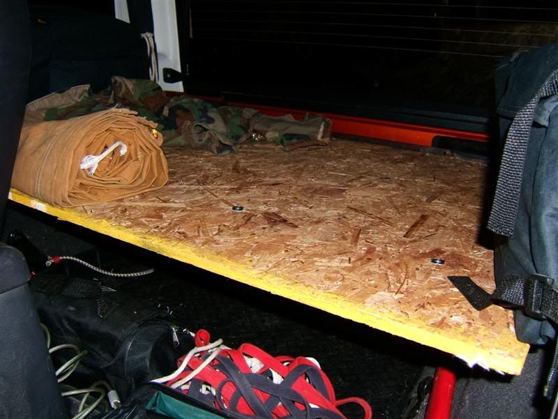

I had a similar concern a while back, as I wanted to be able to put the dogs (3) up top and cargo beneath for daytrips and weekends where we weren't carrying much gear. A 3'x4' piece of OSB for a deck, two side pieces from an old bedframe to span the wheelwells, and a handful of machine screws and thread inserts to keep it all bolted together, and for about $8 I had this:
You'll notice the leashes for the 3 dogs tied to the vehicle in the picture. Total build time was minimal, and the only challenge was figuring out where to cut/bend/reweld to clear the rear lock enclosure thingee.
I haven't attached it to the rollbar bolts (rear) and seat bracket (front, with a drop bracket that I'd fabricate and weld to the front cross piece) as I had intended, but with the Bestop SaddleBags full of recovery gear and whatnot, it has never evidenced any desire to move about on the pavement and mild off-pavement stuff I drive on. It also provides for a nice work surface, too.
EDIT: I just went outside and snapped a couple pictures of it, minus the old blanket/dog bed on top:
The deck surface, with the thread inserts visible roughly 6" back from the front edge of the deck:
From beneath, the only intrusion into the cargo space below is the angle iron of the bedframe:
I don't know of an affordable commercial product that does this any better than a home-made version would. I had planned to do a square tube steel with aluminum skin design, but after seeing how well the quick-and-cheap version I put together has worked out, I really don't see the point in spending $100+ on good metal to do an artful job of it.
Cool. Looks close to what I'm interested in doing....is it attached...or does it just sit on the wheel wells?

computeruser
Right now, it just sits there. The rear crossmembers extend far enough to utilize the rear sport bar as a stop for unwanted forward movement, and the rear gate acts as a stop on unwanted rearward movement. The front seats (this is a TJ after all...no room for anything if the rear seat was till present) touch (gently) the leading edge of the deck, and the reclined angle of the seat serves to restrict any unwanted upward movement at the front of the surface.
This design is sturdy enough for dogs (1 golden, 2 pugs = 100 lbs) and for groceries, plants, a few bags of topsoil, etc. It is NOT sturdy enough for my 230lbs to climb around on it - it flexed a bit more than I was comfortable with when I tried crawling on it. But for a whopping $8 and a small piece of an after-work evening, what can you expect?
Now that having been said, I've got to say that this thread has me seriously thinking about redoing my shelf out of metal, making permanent enclosures where my soft-side saddle bag things are, and making a spot to hardmount my inverter, compressor, and maybe a fountain drink machine. And I haven't even finished my off-road trailer yet! This site is...a bad influence.
