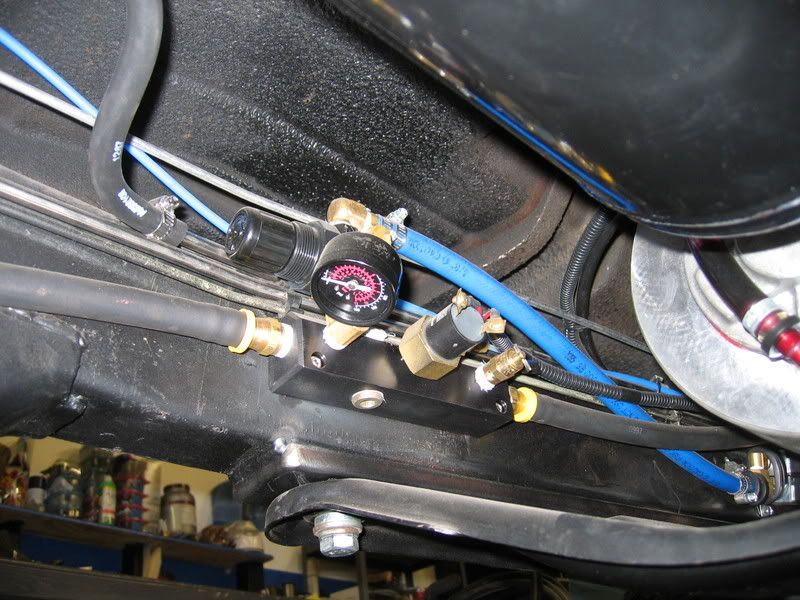

Air manifold and pressure regulator to drop the pressure down for the ARBs, but keeps the pressure up in the tank for air tools.

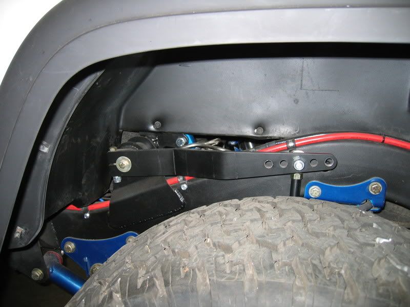

Rear Sway bar, that also doubles as the rear shock mount.

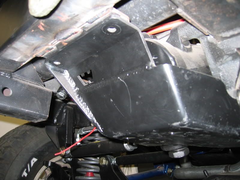

Warn steering box skid plate and I redid to clear a steering box brace.
You can see most of the steering box brace in this pic. This is why the skid had to be modified. Also, you can see some of the parts for the Lee hydraulic assist power steering.

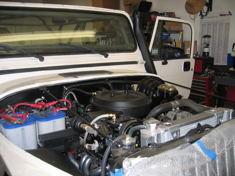

Thank you all for the compliments. Yes, a YJ with a 5.7 is going to be very fun! As for it being really clean, the owner is very particular with all his vehicles...you could eat off everything he owns! Just to give you an idea, when the Jeep leaves here it will have the interior Line-Xed and the Exterior repainted. I'm just happy that he really likes the work that I've done. I was able to rewire the whole thing and use the stock fuse block and power distribution box. There is no wiring just "hangin out" under the hood!

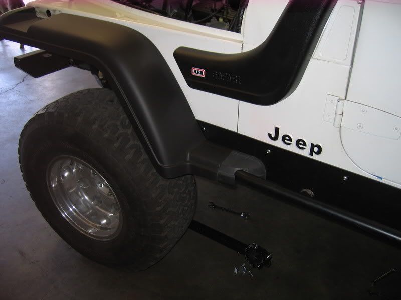

Finished installing the new Warn fender flairs and made an end cap out of one of the stock flairs.
