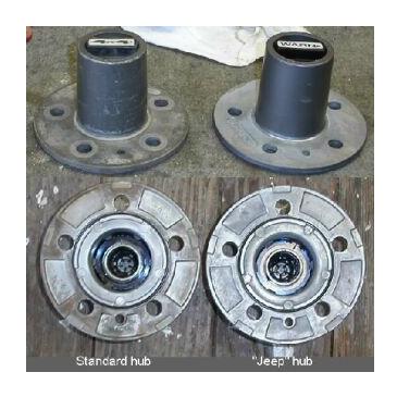

I have a big rubbermade tote of Warn lockouts in the barn. For a couple years the JY sold them $9.99/pr and I rarely passed a pair up knowing they would eventually dry up.. and they pretty much have. Which reminds me I need to dig out a pair for the trip. Two of those are the automatic hubs that came with my axle, spindles are a PITA to pull, I found that one just laying on the ground so I nabbed him too.
There is a heavier duty Warn hub you can get, originally made for the rear of a Jeep D35 when it is being towed. Supposed to be a lot better... hard to argue with the price of used regular ones though.
Front lockers are hard on hubs, I had thought about doing a limited slip out of a Jeep but never found one before the axle went in, I didn't look really hard either. A selectable locker would be nice so it is either there or it isn't there... maybe someday.

I actually have those hubs on my XJ I got a used Hub conversion kit for my D30 on my XJ years ago. They are noticeably heavier
