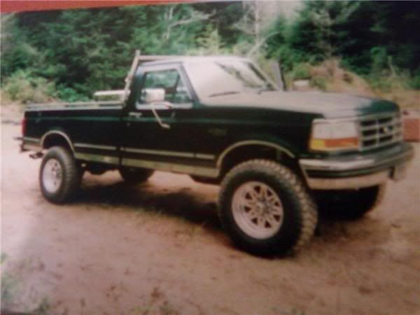

my buddie has 35s on his 95 wit no lift abd the bumper moved 1.5" forward. I dont have great pics but here is what i got. Bolth trucks are running 18's
and his new 95 x-cab with 35s and 4"
