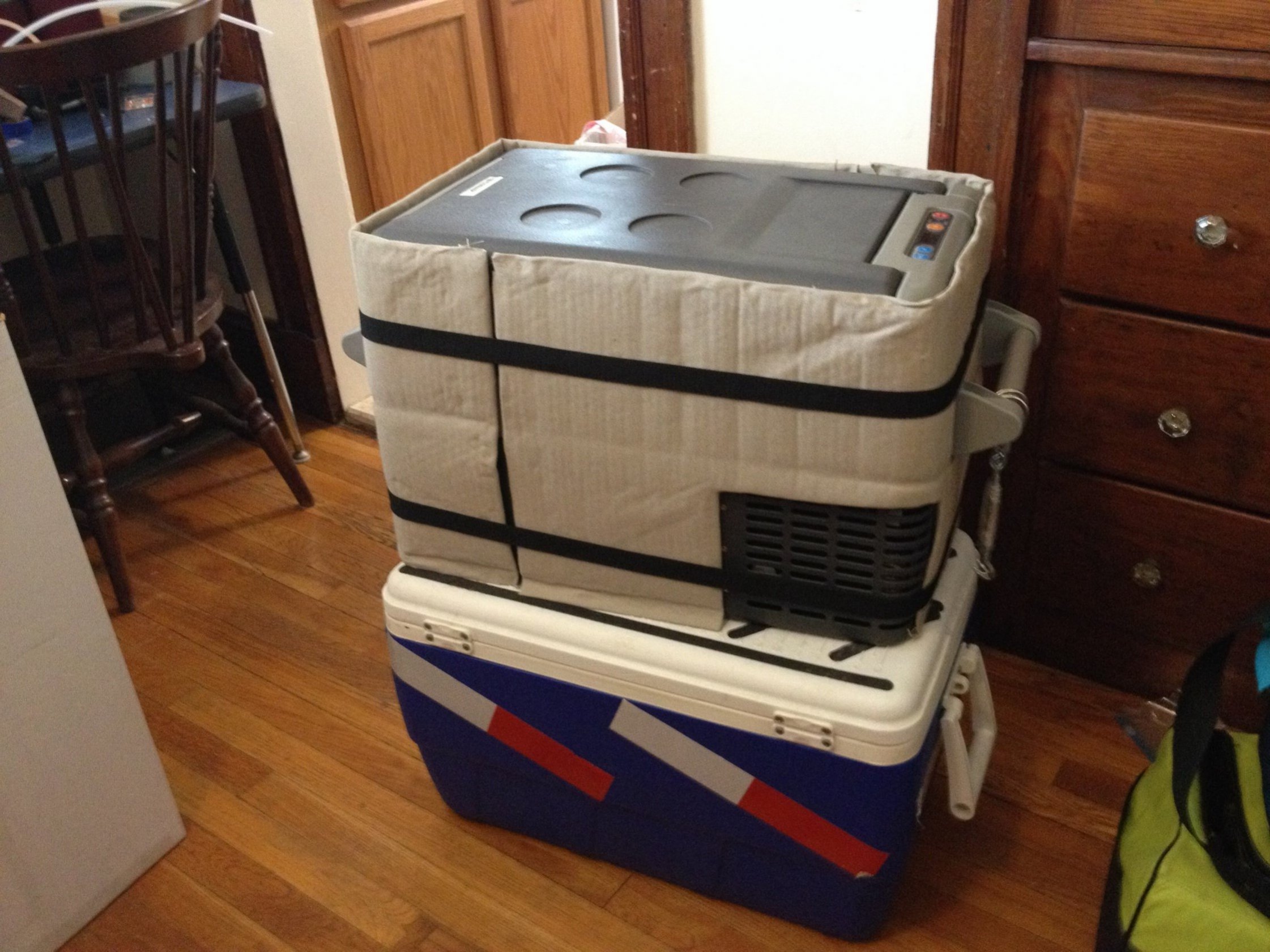

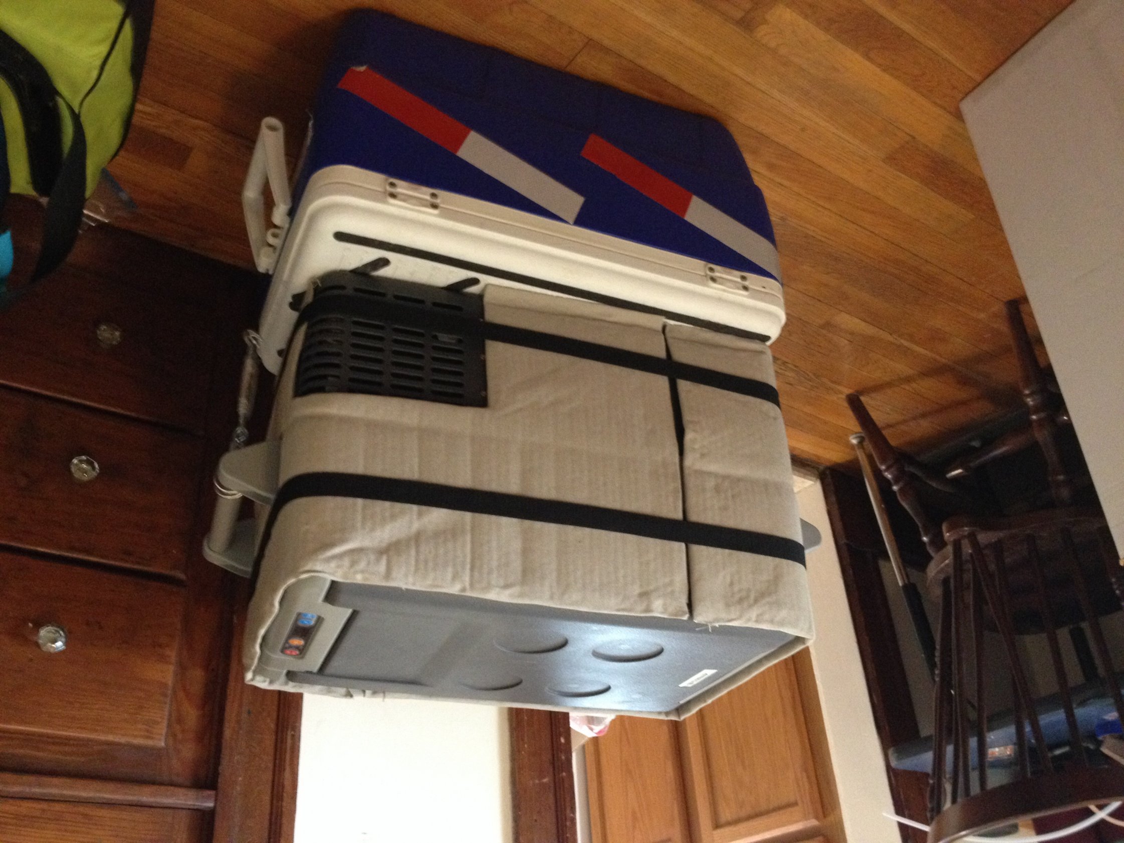

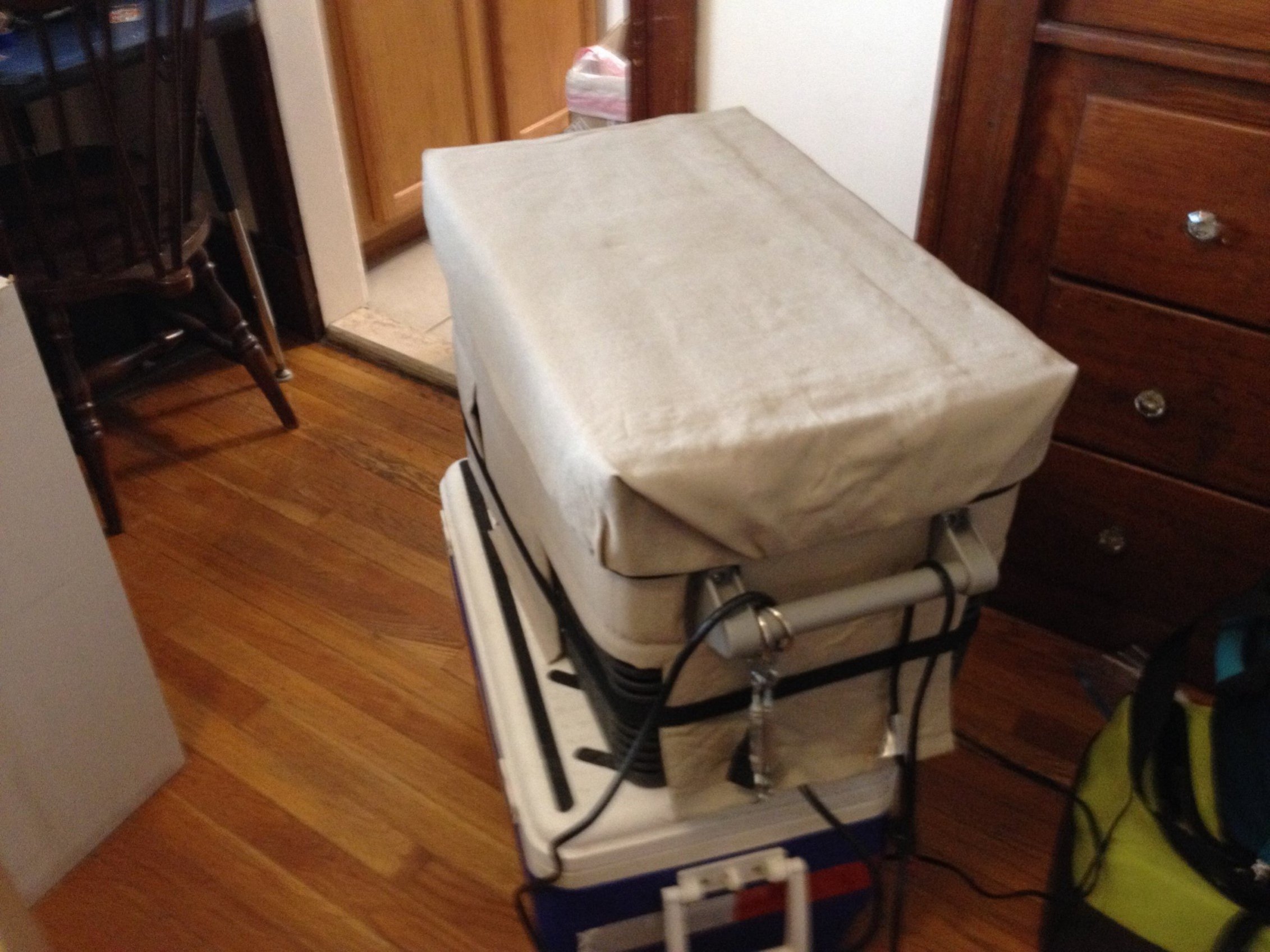

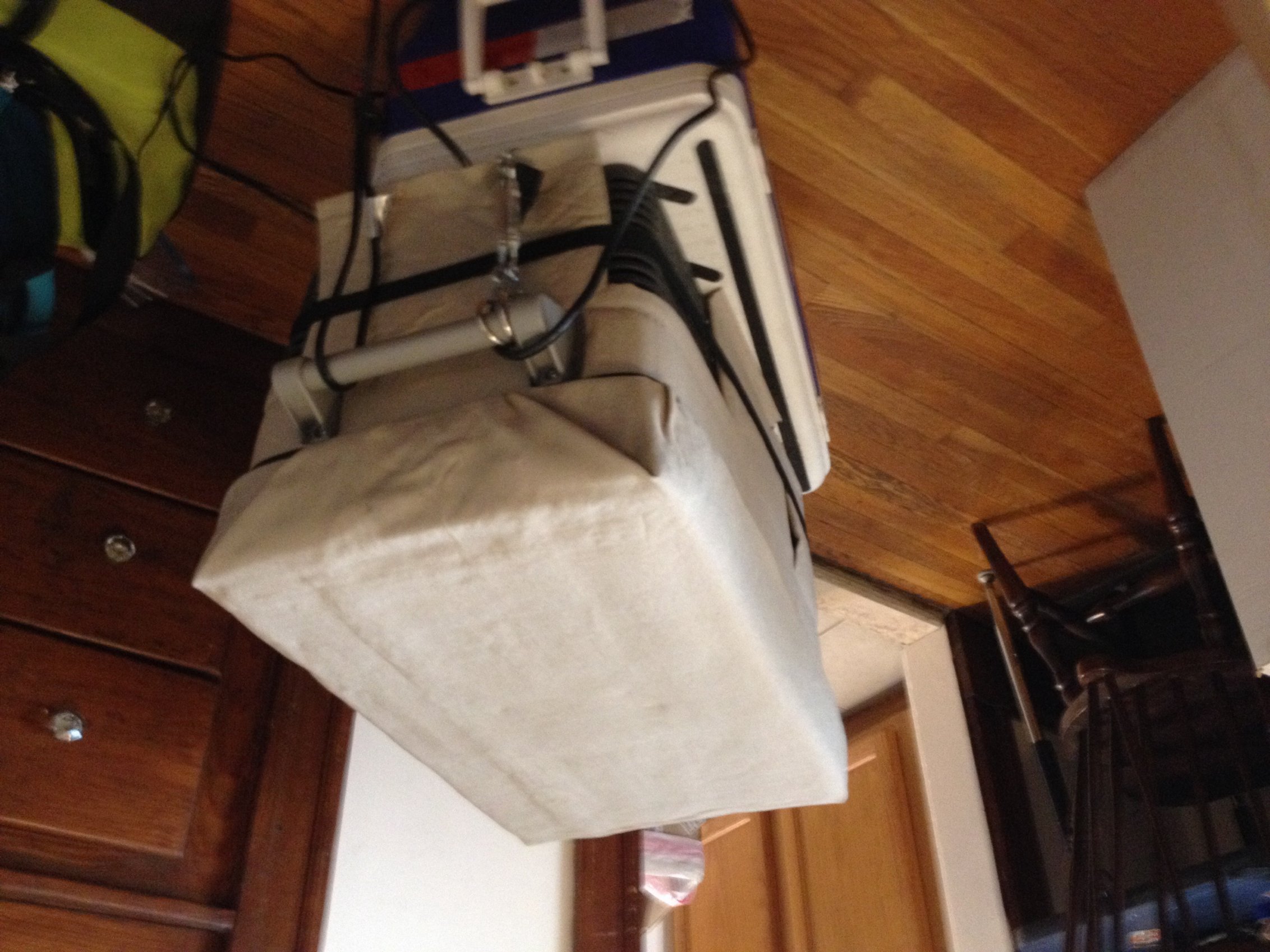

I took a break from packing & decided to complete my fridge cover project. It doesn't take long & could be made to fit probably any unit.

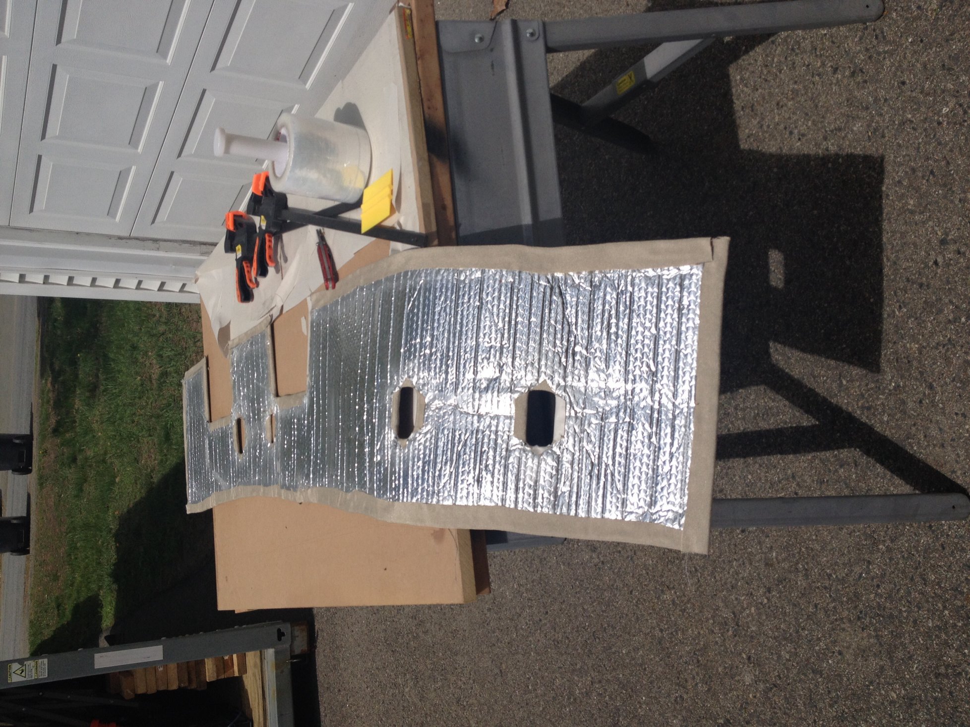

First I had made a cover using reflectix insulation, with cutouts for the vents. I'd been using that cover since last season & it works fine, but it looks like a big block of tinfoil...

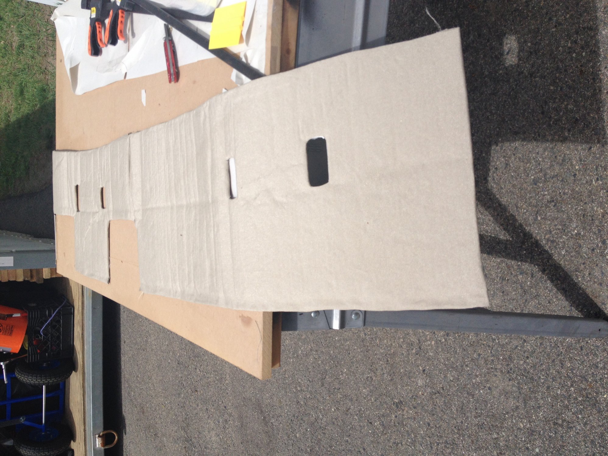

I had some tan nylon/duck fabric by the yard allready around from another project. It's almost a perfect match to my coleman hot water on demand case.
I basically slit the reflectix cover down a side, then sprayed the outside with 3M "77" adhesive. Then stuck the nylon duck onto the reflectix.
Total cost-maybe $20. $10 for the fabric, and $10 for the adhesive. I allready had the insulation, so honestly forget what that cost.
I forgot to leave extra fabric tabs on one end, which I could have attached fabric stick Velcro onto. Looks like the straps I used will hold it in place nicely though.
