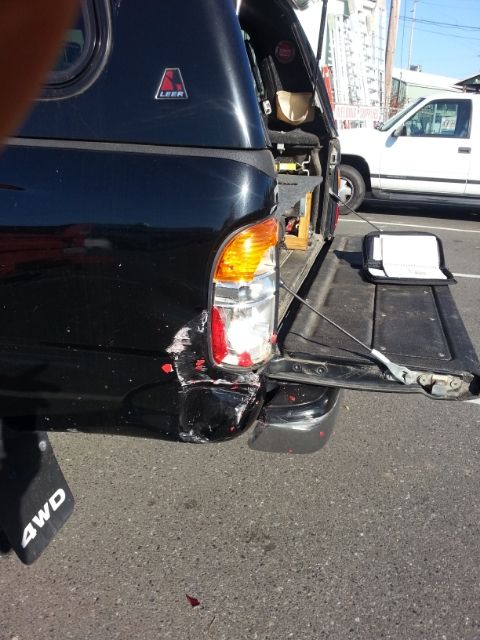

So, I was getting ready to back out of my parking spot at the local hardware store when I saw a car coming into the lot. I stopped and let him go by, then started backing again. I was part way out of the spot when suddenly I see the car that just passed me reversing towards me pretty quick. I had time to stop and hit the horn before the inevitable:
It was the icing on the cake for an otherwise crappy week. The water pipe to my house was broken, I'd run my neighbor's cable over with a trencher (thanks locator service), then discovered that the gas fireplace insert that was installed before I bought the house was done so with electrical tape on the pipe threads. It got even better after his insurance company tried to pin 30% of the responsibility on me. That was a fun conversation. After a week or so of fighting I finally managed to get them to accept 100%. It helped that I was able to get a copy of the store security camera footage of the accident. With that they cut me a check to fix the body and replace the tail light and bumper. Apparently a new stock bumper runs right around $650, so I decided to have the body work done but nix the new bumper. I had a bumper lying around that I had made with a friend years ago after seeing Willman's. It's made of a piece of 2x6 tubing that's 3/16" thick. The tow points are made of 2 1/2" x 1/2" flatstock that runs through the bumper to the frame.

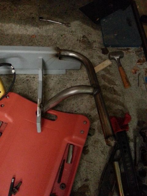

Next up was buying a stick of 1.75" x .120 tubing from the local steel shop. Beefier than what I need, but it's the same size as on the ARB bumper and the CBI sliders. Then I had to find someone who could bend it. Jeverich recommended that I get in touch with Bell Offroad, right up the highway from me. I stopped in and the owner took about an hour of his time to talk with me about what my goal was and bend up the tubing I brought him. I got the side pieces on before the rain really started:
Then notched and added the bracing underneath:
