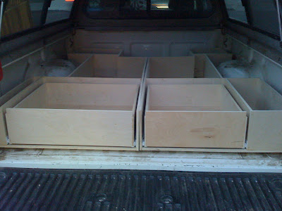

I just built a basic platform for my Tundra out of the sanded 3/4 ply from Lowes. The 3/4 is a bit heavy, but for my use I didn't need to build an additional frame so I may have saved some weight there. Here is a pic, mid way down, unstained or sealed. I have that 3ft middle section that slides in the top or bottom for sleeping or sitting out the storm. Still try to figure out my drawer and compartment needs before
http://expeditionportal.com/forum/showthread.php?t=18914&highlight=tundra&page=2
I just stained and sealed it and it seems to be pretty water tight.
