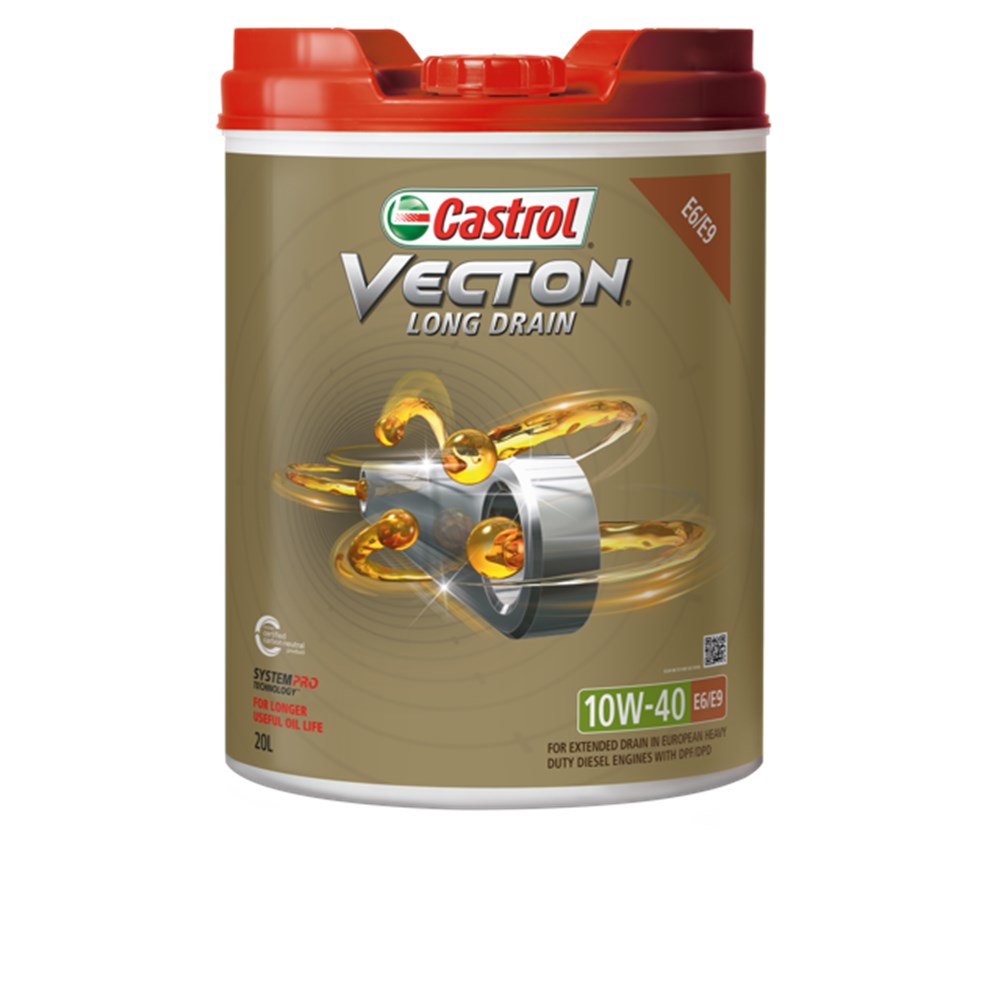

Plan on using 5W-30 for winter and 10W-40 for summer:

I've used a variety, when we are traveling I use the Castrol Ultra Long life oil - 100,000km between changes, and I change the oil filter every 5000km. Much easier to get rid of one litre of oil than 12 litres oil. I change it when I get back after 20-30,000km. Fully synthetic 10W40 mainly,
